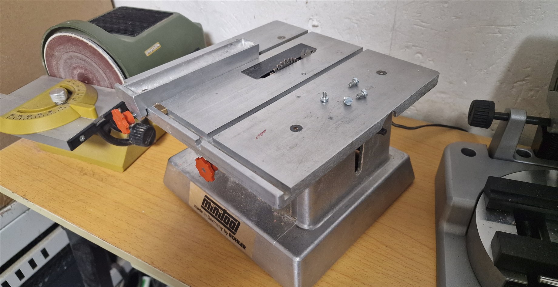

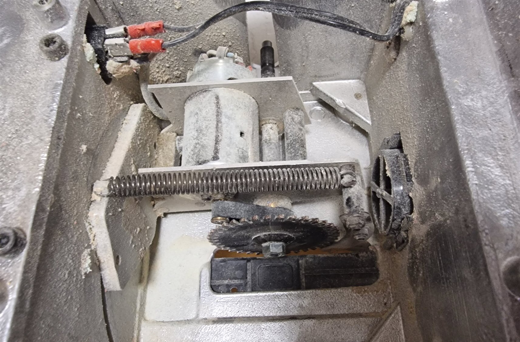

The KS 230 is intended to (possibly temporarily but I’m waiting to try the KS 230 out first – and see my comments later!) replace my older table saw, which is the Bohler Minitool 320 305. It must be at least 20 years old; I’ve had it at least 10 years, and I purchased it second-hand. It’s always been slightly underpowered. Recently, the saw blade has started to stall when slightly too much pressure is applied. I don’t know if the toothed belt needs replacement, it doesn’t look in best condition.

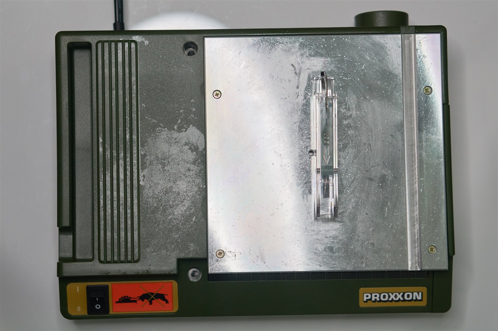

It came with grease on the top surface. Not sure why, since it’s plastic and aluminium. Maybe the supplier did this to protect it in storage. I wasn’t too happy that the mains plug had scuffed the metal, but it’s a minor thing.
The KS 230 has a saw cover visible in the photo below; it’s non-removable, and just lifts and hinges up while you’re sawing. You’re supposed to resist the temptation of ripping it off, because the metal thing it is attached to is supposed to keep the material that you’re cutting straight, because table saws are quite dangerous (the material can grab on the saw blade and propel precisely in the direction of the operator).
Here are all the supplied accessories. The angle guide stinks, it is made of plastic with the metal bar secured with one screw. You will need a square (unsupplied of course) to set it to precisely 90 degrees.
I have other Proxxon tools, and I wish they would do something about their angle guides, those are always poor quality.
I might machine up my own all-metal angle guides for say 90 and 45 degrees one day.
The photo below shows the guides installed as they would be used. Incidentally, that hole next to the saw blade is used with a supplied 2 mm hex key, to hold the shaft locked, while replacing saw blades.
The photo below shows the power switch, and to the right of it, one of the two holes that can be used to screw the table saw to a surface (I won’t be doing that).
The deep recess in the plastic top surface, on the left-hand-side, serves a purpose not currently known to mankind. No supplied accessory fits it.

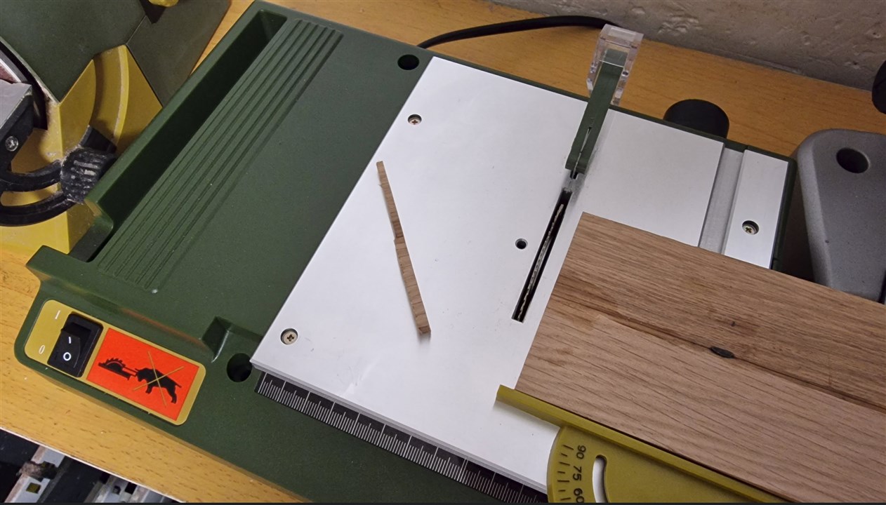

    How could you manage not to comment on this feature ?
  • beacon_dave
    beacon_dave over 1 year ago in reply to shabaz +1
    I'll just use my pet rhino to push the workpiece instead... I'll 3D print some adapters for its horn. I suspect that they realise that the symbols will either wear off the switch or become covered in…

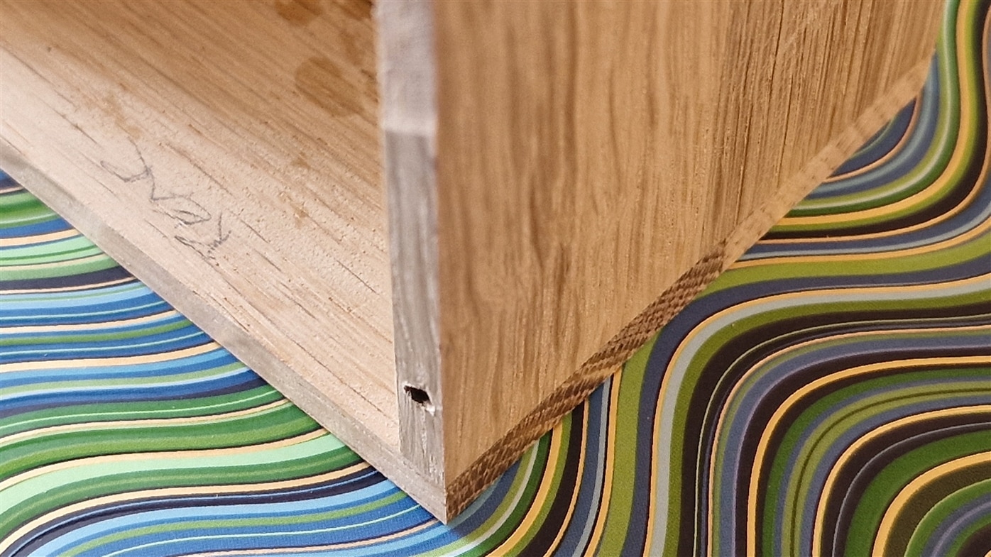

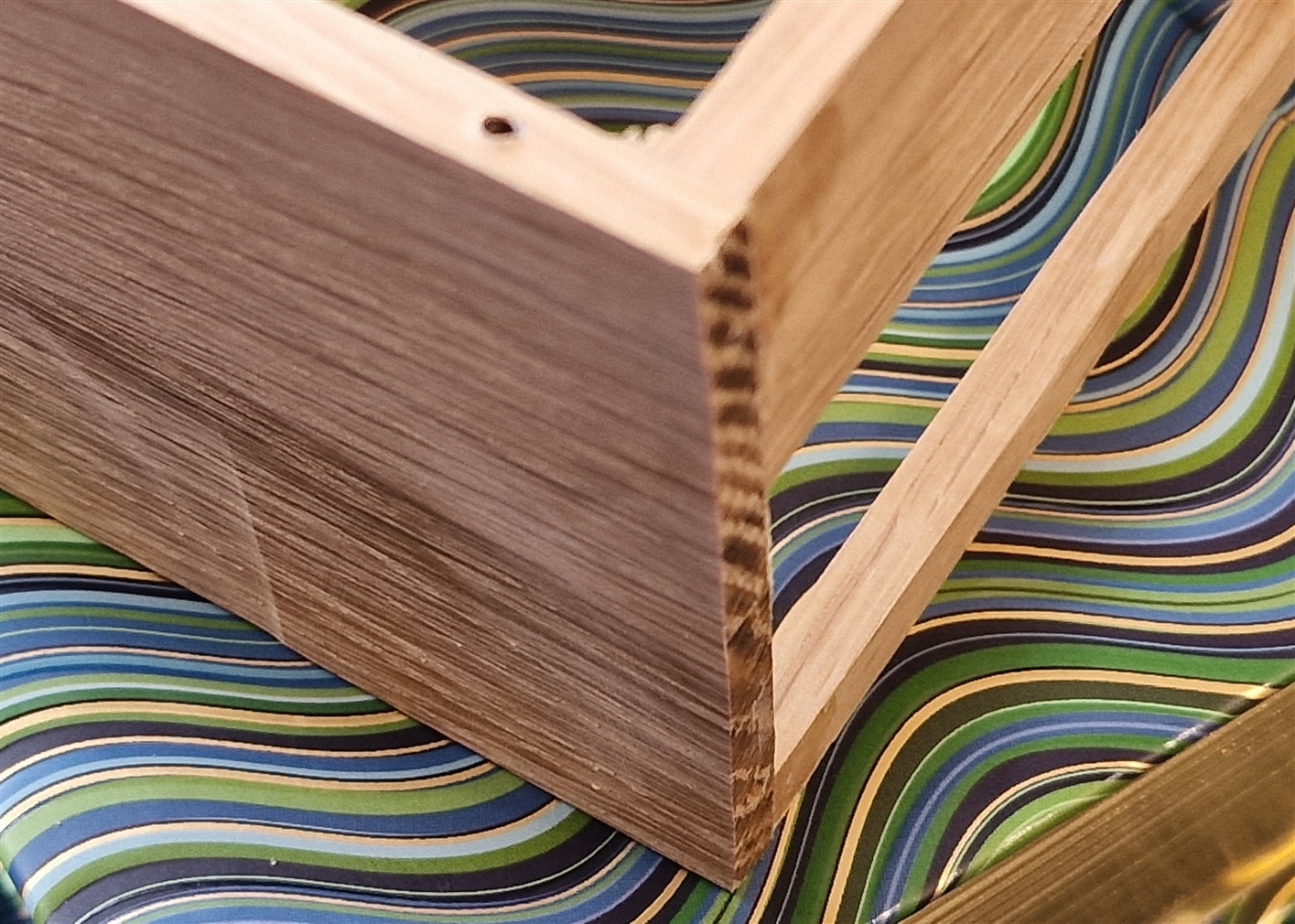

    Made my first box with it today. This is with 6 mm thick hardwood.
    Really happy with the clean cuts.

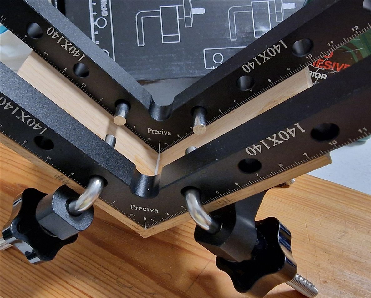

    I used these right-angle clamps. They are just average. Wish I had something better, but I don't know of a decent product at a reasonable price.

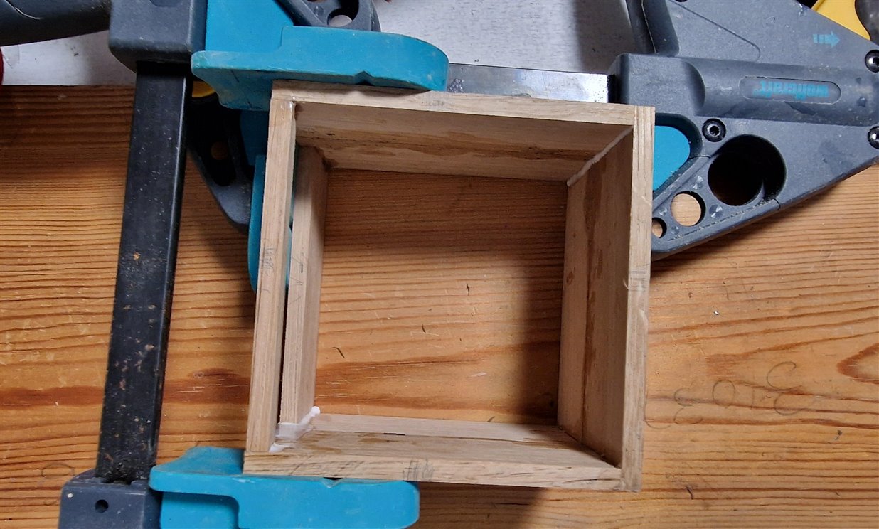

    After I made two sets of the pieces shown in the photo above, then I clamped them together with normal clamps:
    If you're wondering why it looks so ugly at this point, it's because I'm using thin strips of wood, they are glued together to form a wider piece. You can see all the glue seams in the photo above. Afterwards, I sanded it all clean on the outside (using a bench sander - an essential tool!).
    I'm using thin strips of wood because they were cheap - I got a large box of offcuts for about £15. There are occasionally scrap wood offcut bundles on ebay. I don't have a choice what size they are, but that doesn't matter when you can glue many together to make a larger piece, and saw cleanly to make it look as one.

    Hi! You could right. I think the distributor may have moved the cable from its position in the box to install the UK plug adapter around the European plug. I might make a small DIY push stick to fit in there. I was thinking afterwards that the recess also probably helps with rigidity of the enclosure.

    "...The deep recess in the plastic top surface, on the left-hand-side, serves a purpose not currently known to mankind. No supplied accessory fits it..."
    The recess may have been intended as a holder for the power cord when storing out of the way on a shelf or in a cupboard between use. It perhaps helps keep the flex away from the blade in transit.
    I notice that it also exists on one of the scroll saw models, so is not unique to this one.
