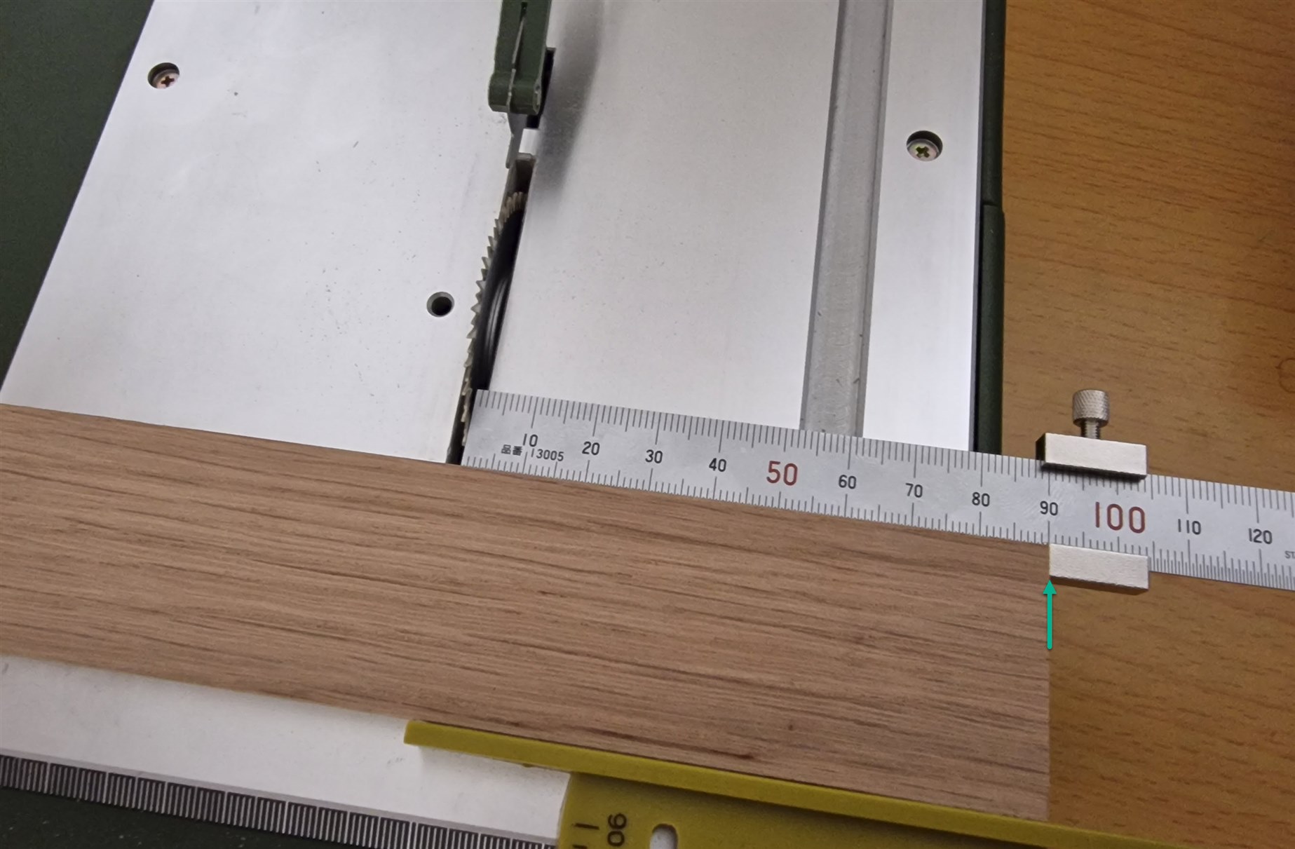

    I've been trying to make the most of the crazy-small table. Here's how I'm using it to cut wood to lengths greater than I can measure off with the table, this method is working quite well, I've cut half a dozen pieces using it now.
    First off, straighten up the edge by just trimming the wood as shown below. Obviously, make sure that the yellow plastic angle guide is set to 90 degrees, a small engineers square is helpful to do that.
    Next, use a steel rule with adjustable stop, and set it to your desired length. Push the wood against the stop (i.e., the straightened-up edge of the wood), as shown with the green arrow in the photo below. The other end of the ruler should be just touching the blade.

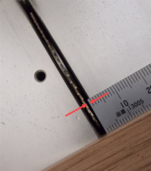

    In theory, you could now remove the ruler and proceed with the cut. However, in practise, you'll need to offset the ruler very slightly, a fudge factor to account for the teeth on the saw blade causing the cut to have more thickness than most of the blade. For my blade, that fudge factor is about 1 mm, you can see in the photo below that I pulled the ruler apart from the blade by a millimeter (which is easy to eyeball, I didn't measure that), With this method, the error is within about half a millimeter with the final cut.
    I'm sure there are better techniques, but this one seems easy enough to do, and the results so far are good, I'm getting very accurate cuts.
