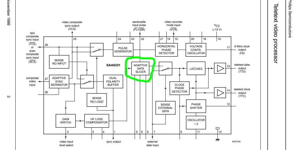

    jc2048 over 1 year ago in reply to shabaz
    Teletext used an adaptive data slicer. You can see it here in the analogue video processor part of one of the Philips' chip sets (the other chip was digital and did the decoding, storage, and generation of the display). That tracked the low and high levels to derive an appropriate slicing level. There were external capacitors to store the levels, so you could get an idea what it was doing. Later, when they got their digital TV stuff going, it would instead have been processing after the digitisation and simply disappeared into a big chip.
