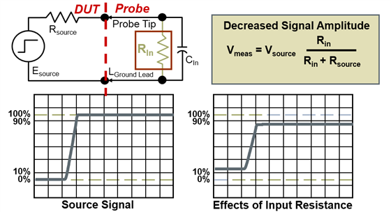

The probe will have its own Input Resistance. This resistance will create a voltage divider with the source resistance of the signal under test. You can see from the simple equation below that if the input resistance of the probe is much greater than the source resistance then the Vmeas will tend to equal Vsource (two resistance in parallel tend towards the lower value of the two).
So generally a high source resistance is desirable in a probe to reduce DC loading effects by the probe and give accurate DC measurements. A 1x passive probe often have resistance in the region of 1Mohm, and many output stages are typically in the region of 10's or 100's of ohms. So a 1Mohm resistance would have every little effect on the DC levels of signals.

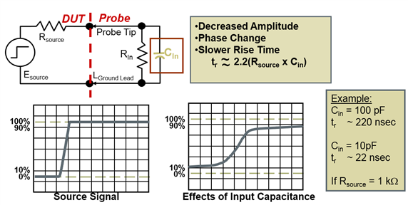

As signals becomes faster and faster as switching times become shorter, by far the most important characteristics of the probe is the input capacitance. When moving away from DC and low frequencies the input impedance of a probe is dominated by the tip capacitance. The smaller the input C then the larger the probe impedance and the smaller the AC loading effect. The capacitance also has an effect on rise times. The picture below illustrates the effect a probe would have if I had an ideal 0nS step from my device. As you might remember, a capacitor fights changes in voltage.  Therefore, if you drive a 0ns rise time pulse into a capacitor, it will take some amount of time for the capacitor to respond to that voltage change.  The amount of time is determined by the time constant of the RC network. The figures below try to show a good estimate this effect. If the input resistance of my probe is 1Kohms and I have 100pF Cin then my rise time would be in the region of 220nS. If I can cut my Cin by an order of magnitude then the rise time scales down with it. (note for convince I've assumed that the probes resistance Rin is much larger than the source resistance Rsource.
Generally, standard passive probes have input capacitance in the region of 10-12pF, while the active probes are less than a pF.
