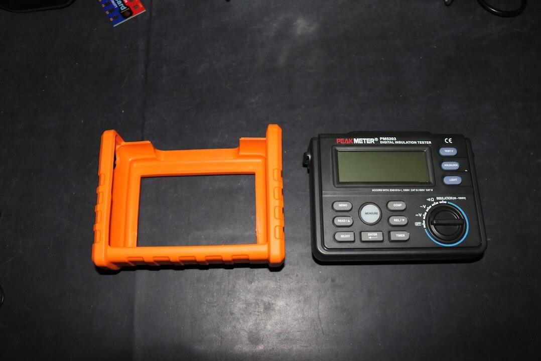

Unboxing and Overview
The PM5203 comes with a soft carry case, that contains an instruction manual, the meter, a set of leads with moulded probes and a set of crocodile clips. A shoulder strap is also provided for the carry case.
The meter itself has a removable rubberised boot for protection. The front face of the instrument shows the LCD display, the rotary function selection switch and a number of operating buttons to carry out the test various functions, memory and comparator operations. The meter has a moderate set of capabilities in comparison to other insulation testers reviewed.

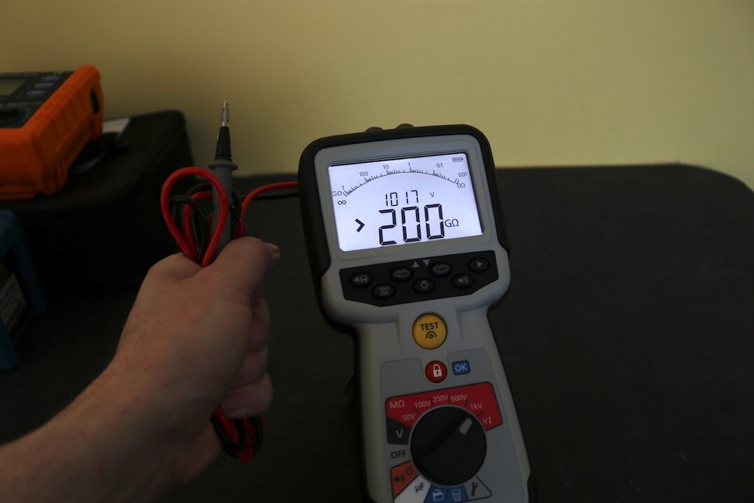

The test leads provided are silicone insulated so have a good flexibility and test out above 200 GOhms at 1000V, so will not affect the insulation test readings.

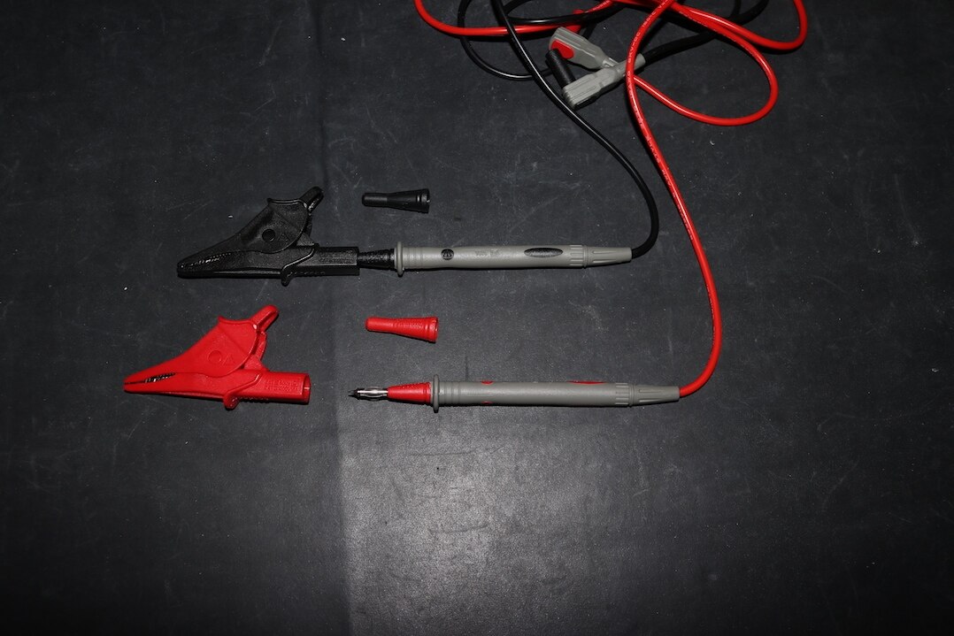

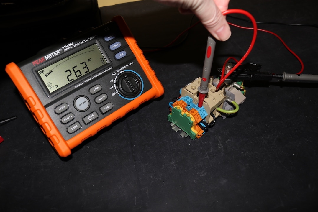

The probe tips have GS38 compatible caps, but I found these to be very difficult to remove to the extent that I end up damaging the caps by prying them off, as can be seen below.
The style of the caps restricts access to the smaller terminals. For these the cap must be removed. The cap must also be removed to utilise the crocodile clips. These are a good size and will easily attach to 12mm motor studs. However, the arrangement of adding them onto the end of the probes makes for a bulky configuration, that can be restrictive around smaller motor terminals.

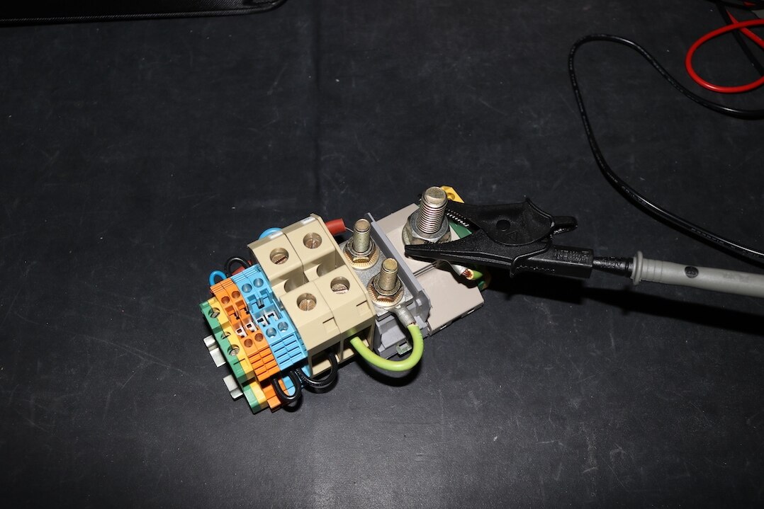

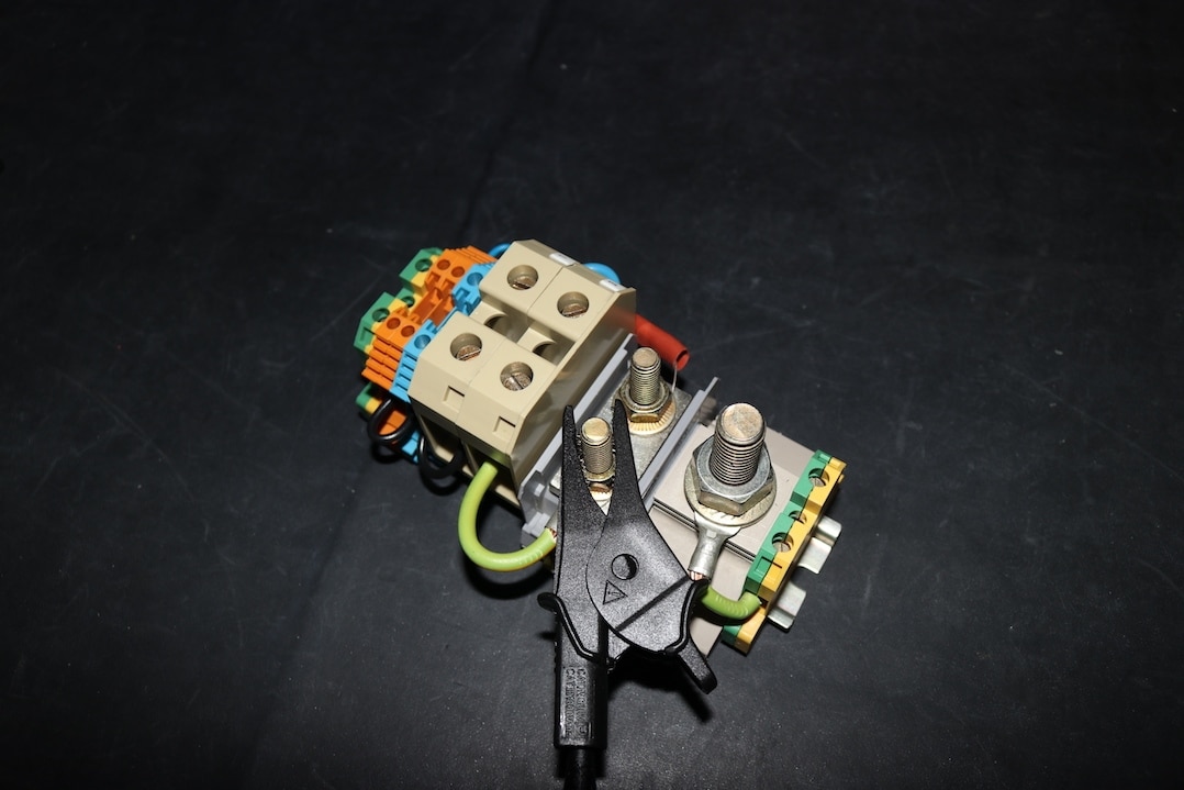

{gallery} PM5203 Probe Connections
Crocodile clip arrangement for PM5203
Probe with GS38 cap fit into 35mm terminal
Probe with GS38 cap will not fit into 4mm terminal
Probe with GS38 cap removed fits into 2.5mm terminal
Crocodile clip on M8 stud
Crocodile clip on M12 nut

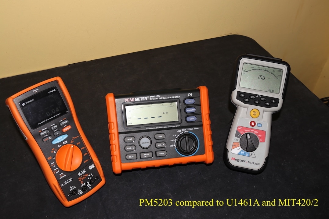

The meter itself is rectangular in format and is a different style to the majority of other insulation testers on the market. Probably the closest would be the Hioki IR4058 that I reviewed back in March 2020. It is certainly different to the U1461A and MIT420/2 instruments that form my baseline insulation testers for comparison during these reviews.
The display is actually quite nice on the PM5203, with the around three-quarters of width being used to display the numerical value and a curved analogue bar-graph displayed above the digits. The display is crisp and easy to read and also has a good backlight.

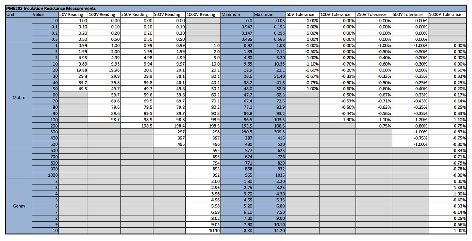

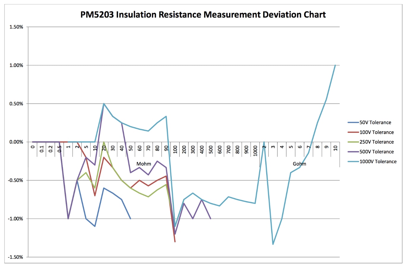

To be honest, I was expecting great things with this aspect of the review, but none the less, I ran the instrument through my standard set of tests for evaluating an insulation tester. Lets start with the main insulation test function, due to the restricted test range, I managed 99 tests through the decade resistance box. Response was very respectable, with a maximum deviation of 1.33% being seen.

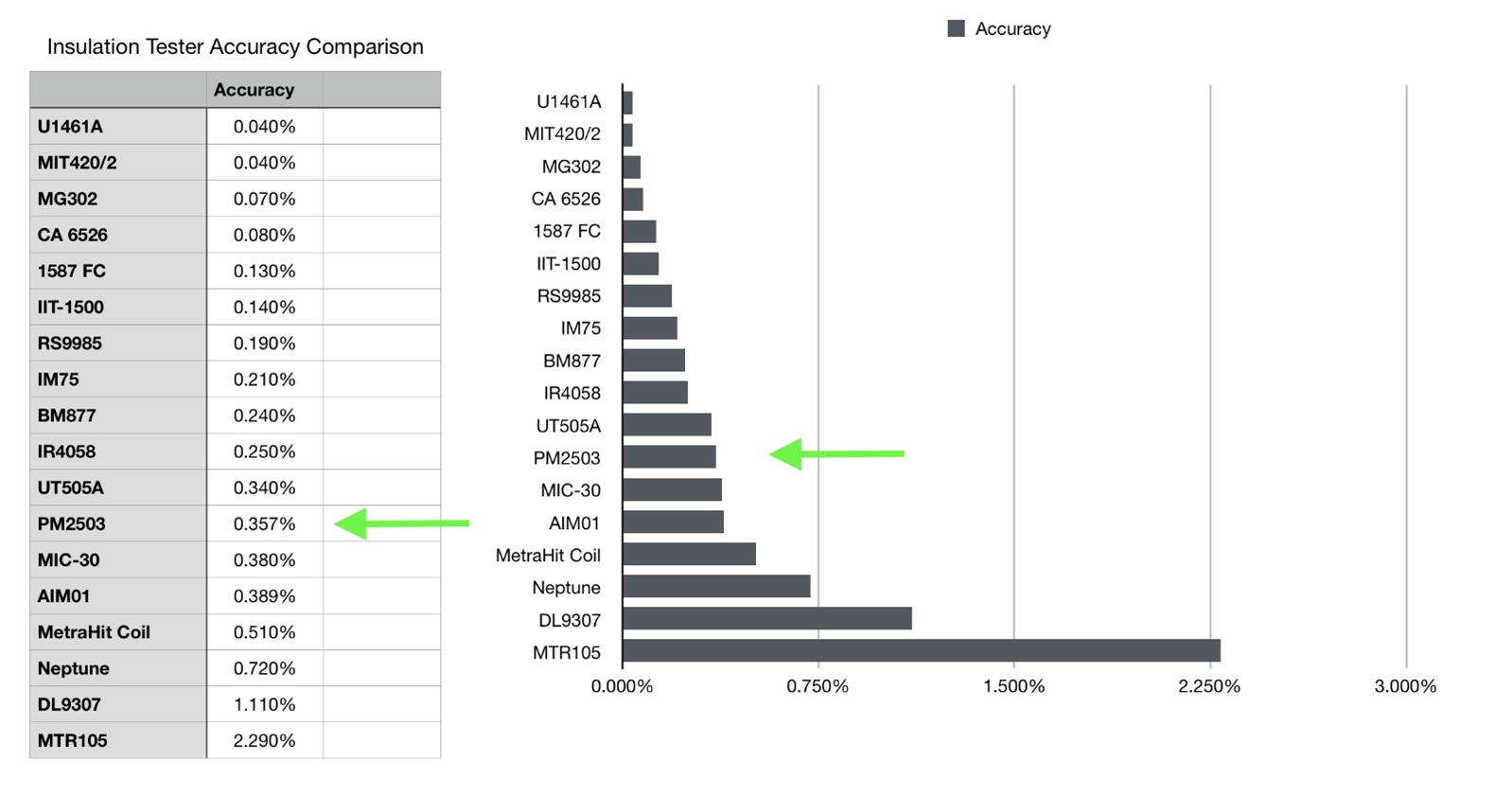

The deviation plot below shows a reasonable comparison across the different test voltages, with the highest deviations being seen for the 1000V test range, where much higher resistance values are measured and lead to greater in accuracies by design, as is the case for all 1000V insulation testers.

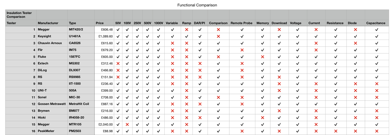

In comparison to other instruments, the PM5203 falls in the bottom third for the overall average accuracy, sandwiched between the UT505A from Uni-T and the MIC-30 from Sonel.

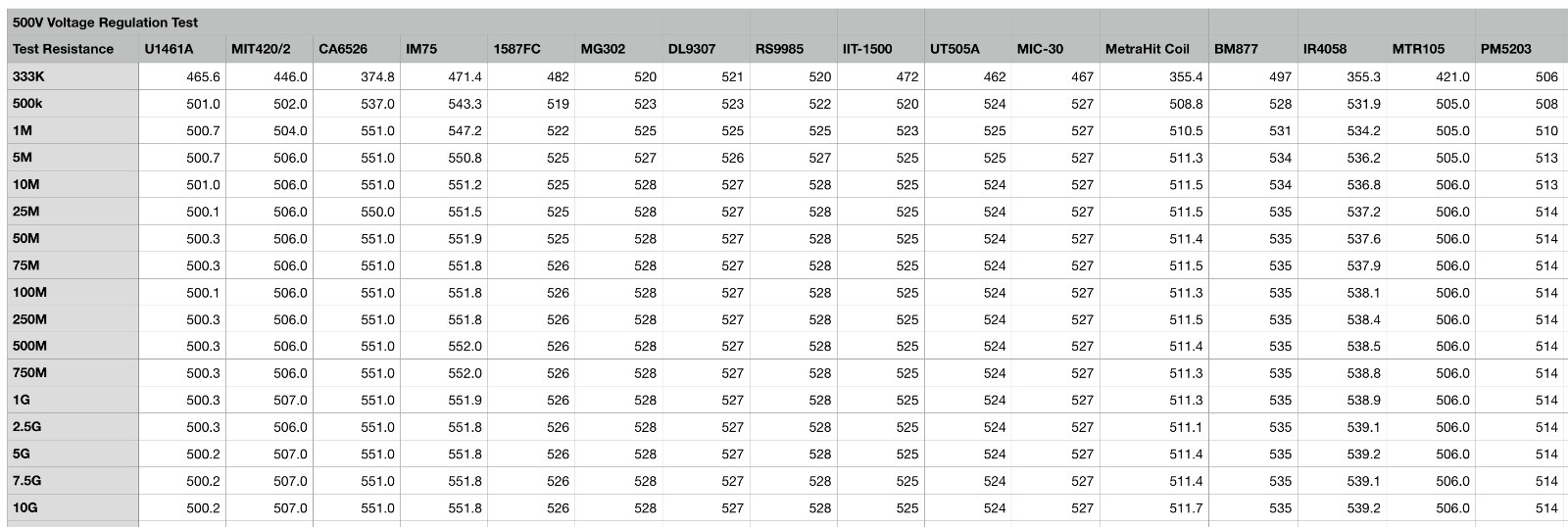

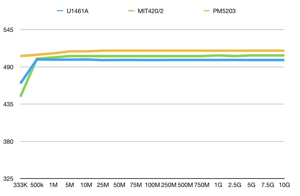

Voltage regulation on the 500V test range, as seen above, shows a little more spread over the entire test range than the two base units. It is still a respectable result though and better than a number of the insulation testers already reviewed.

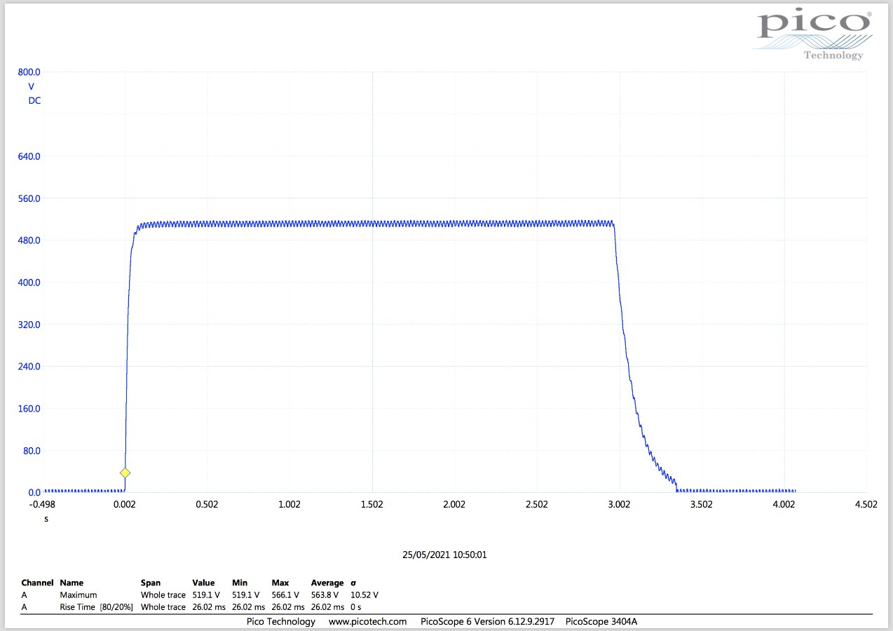

The screenshot above shows the output curve of the PM5203 at 500 V. It shows a fairly fast response with a rise time of 26 ms, there was no noticeable voltage spike before there steady output was seen. The scope recorded a maximum of 566 V.

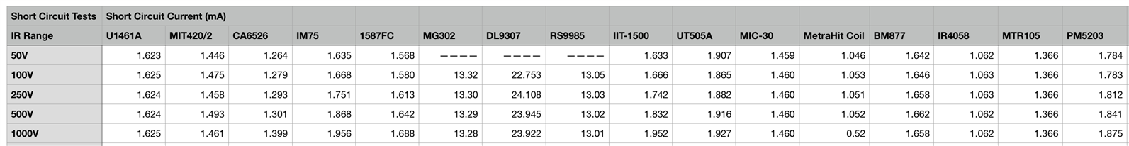

The short circuit current was consistent over the voltage test range and was a little higher when compared to a lot of the other instruments. This is still well within the tolerance requirements of the IEC 61557-2 standard and a higher short circuit current can be useful when charging highly capacitive test objects such as long cables.

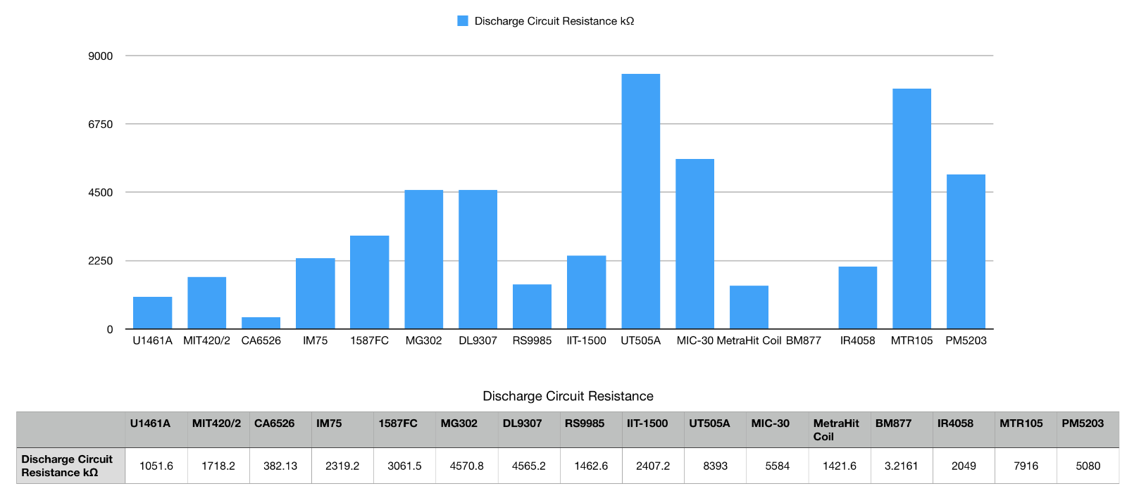

At the end of each insulation test, the meter briefly switches to a discharge mode. The discharge resistance was measured at a little over 5 MegOhm, which is on the high side in comparison to other instruments. There are however, a few instruments that have a higher discharge resistance as seen below.

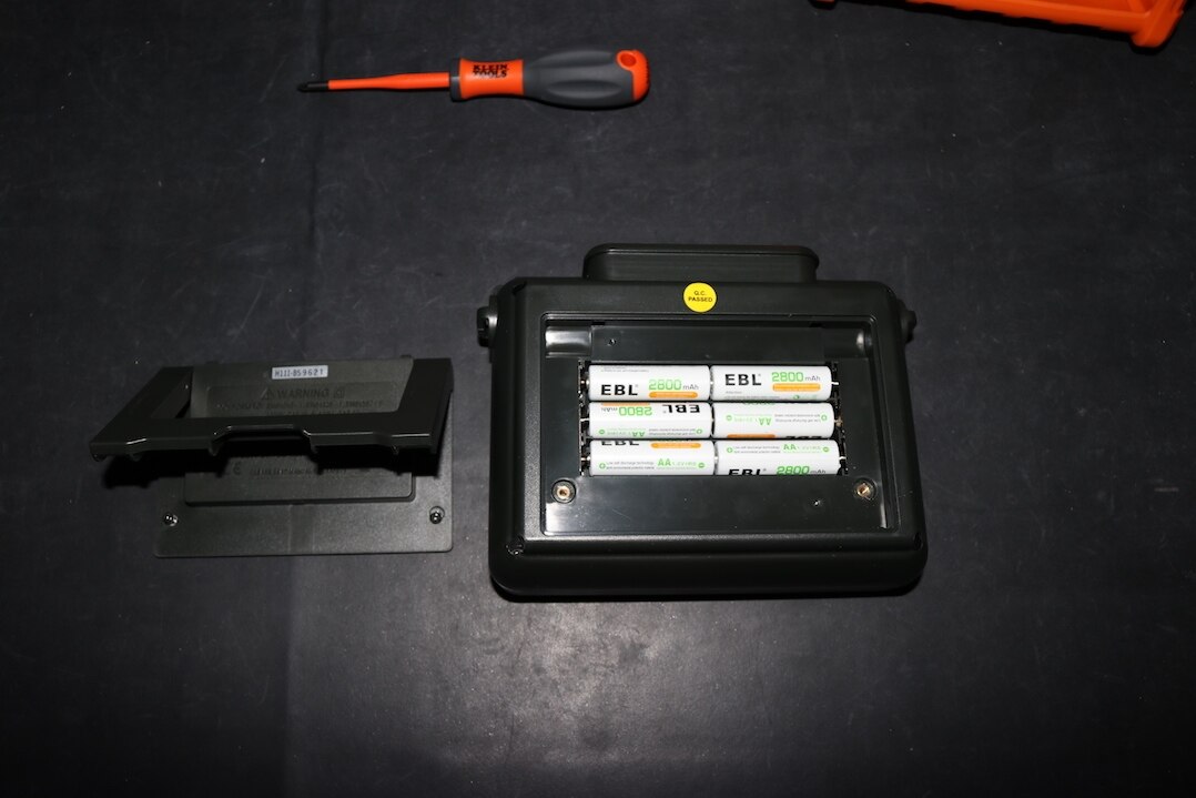

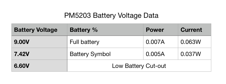

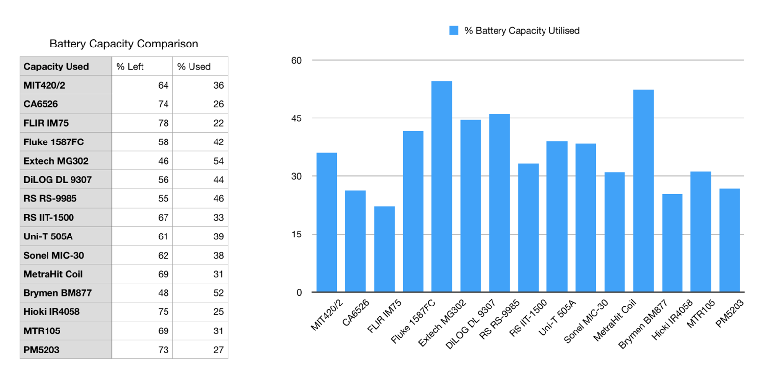

The battery pack for the PM5203 consists of six AA cells, a fairly common set up of insulation testers. Having a limited set of functions, there aren't many load tests to go through, as seen below. All tests showed less than a 1W load, which is a low set of readings, indicating the potential for good battery life.
Battery monitoring within the PM5203 is a simple affair. There is no battery symbol present all the time, the low battery symbol came on at 7.42V, followed by the tester cutting out at 6.60V.
This is a worse than average performance in comparison to the other instruments tested, with only around 27% of the battery capacity being used before the meter cuts out.

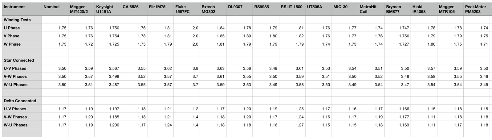

Winding Simulator Tests

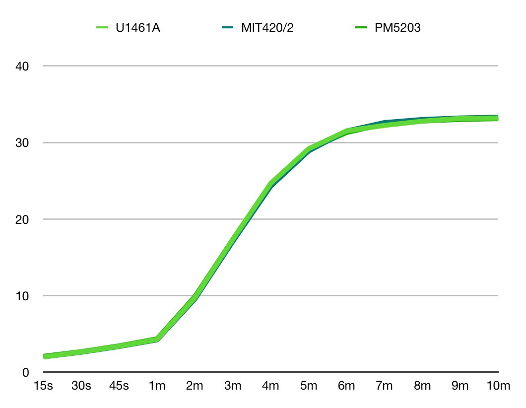

The PM5203 has both DAR and PI test capabilities, so is an ideal candidate for testing on the motor winding simulator.
Selection of the test function is not immediately obvious as it is with other instruments as DAR and PI are not directly selectable. To select DAR and PI, the Timer mode must be entered and then the timer set to 1 minute for DAR or 10 minutes for PI. If set for either of the values, the instrument knows to perform the relevant test when started and will display a DAR or PI emblem on the display to let the user know. It was noted that when PI test was selected, the DAR ratio was also recorded, something that a lot of instruments do not do.
When in DAR or PI, the test auxiliary display can be cycled between the actual test voltage and the test duration. Using this function, the interim resistance values can be manually recorded to create a resistance plot over the 10 minute duration. Whilst the end result can be saved to one of the nineteen memory slots, the meter only saves the ratio and final resistance values.
The resistance plot from the PM5203 matched the baseline plots from the U1461A and MIT420/2. The DAR ratio of 1.63 from the PM5203 matches the expectations. The PI ratio at 7.59 was a little below the expected 7.80, due to the slightly higher 1 minute value obtained from the PM5203 in comparison to the other meters. However for the purposes of electrical testing the results obtained from the PM5203 were perfectly acceptable.

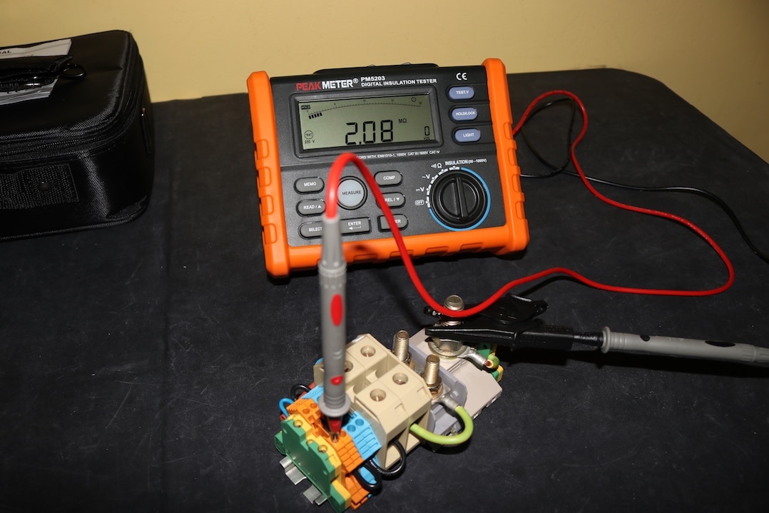

As already identified, the resistance / continuity function is limited to a 1mA test current against the preferred 200mA offered by a lot of instruments now. Despite this, the results were very respectable with the worst case result being 2.3% from nominal value. The 2 digit resolution enhances the test and provides a better result than some more expensive instruments reviewed. It would certainly be interesting to get hold of an MS5203A unit that does have the 200mA test current to carry out a comparison.

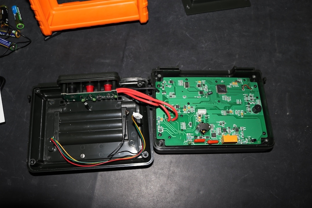

The PM5203 consists of a hard plastic case, surrounded by a removable rubber boot. Whilst the case seems to be relatively consistent across the many variations of this model of insulation tester, the rubber boot seems to change colour dependent upon the manufacturer. For Peakmeter the boot comes in a high visibility orange. The rubber boot is relatively easy to remove and seems to hold itself in position via several recesses in the plastic case.
At the rear of the meter, the battery compartment can be removed with the rubber boot still on the instrument. The battery compartment lid is held in place by two machine screws at the bottom and plastic clips at the top. Brass inserts for the machine screws can be seen in the case. The foldable stand comes away with the battery compartment lid.

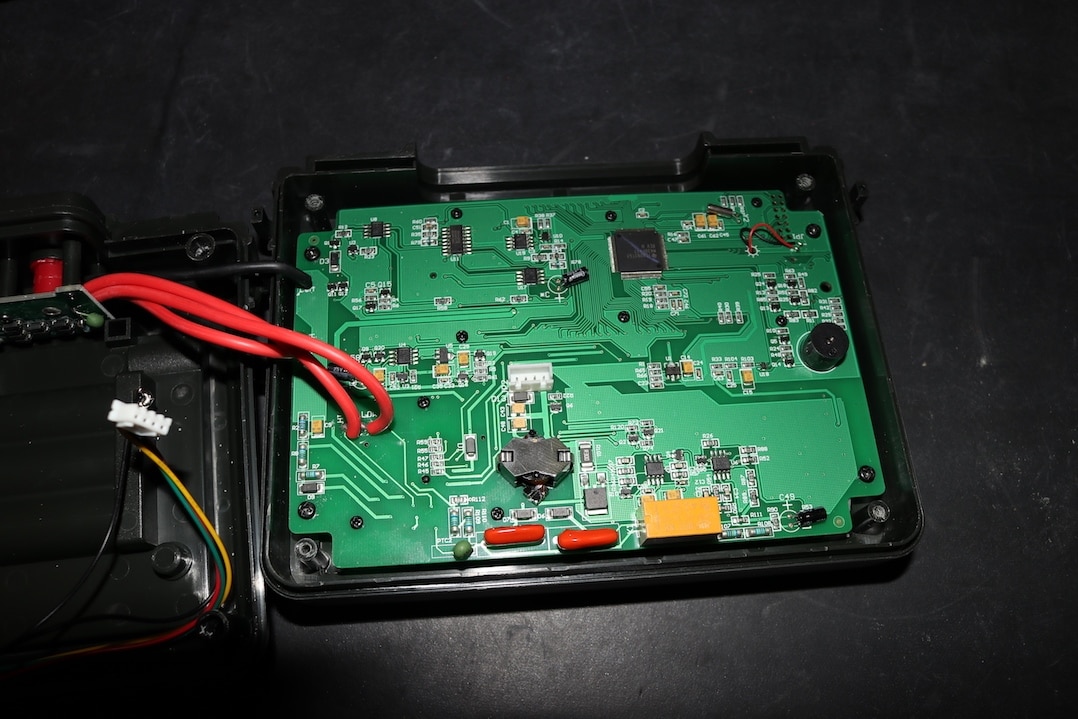

The case is then held together by a Philips screw in each corner. Removal of these allows the instrument case to be split in half to reveal the main circuit board and a smaller, separate board by the input jacks. The lead for the battery compartment can be unplugged and the rear case half moved away, but the leads to the input jack board are hand soldered at both ends.
The smaller input board looks to contain some rectifier diodes and PTC. There is no evidence that I saw of a voltage dropper circuit on this board or any other form of input protection such as gas discharge tubes or varistors. The continuity function does not appear to be fuse protected. The input board is screwed to the plastic case with the input jacks soldered directly onto it. The arrangement does look to be secure.
The vast majority of the components are on the main board screwed into the front half of the case
The four corner screws can be removed and the complete PCB lifted out.
Interestingly, the rotary function switch turns out to be a completely enclosed unit, which is unusual in comparison to other instruments I have looked at. The push buttons are the PCB / carbon pad arrangement commonly seen. There was some evidence of flux residue on this side of the board around the areas that appear to have hand soldered joints. By the side of the rotary switch, the MS5203 designation of the Mastech unit is a clear giveaway of the origins of the PM5203.
With the PM5203 being a relatively basic insulation and continuity tester, there isn't much going on within the case. I have identified the main processor as a M430F437 micro controller from Texas Instruments. The details are readily available for this, which is nice as I have deliberately chosen this unit to do some reverse engineering on to enable me to learn more about the internal functioning of an insulation tester.
