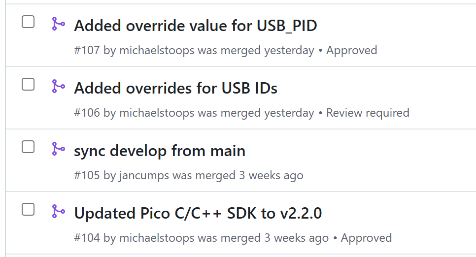

Michael Stoops submitted pull requests to make a set of USB parameters configurable in your CMake file.
What USB IDs can be configured?
  • USB_VID
  • USB_PID
  • USB_MANUFACTURER
  • USB_PRODUCT
  • USB_SERIALNUMBER
  • FW_VER_BCD
  • FW_VER_STR
Before this new functionality was introduced, these attributes were defined in the LabLib source code. They had the same values as those of the Pico SDK examples.
When you want to commercialise a device, you need to set those to IDs that you license from the USB.org, and to your internal IDs.
In the past, you needed to alter LabLib's source. You can now define these, in the build file (or from the command line).
