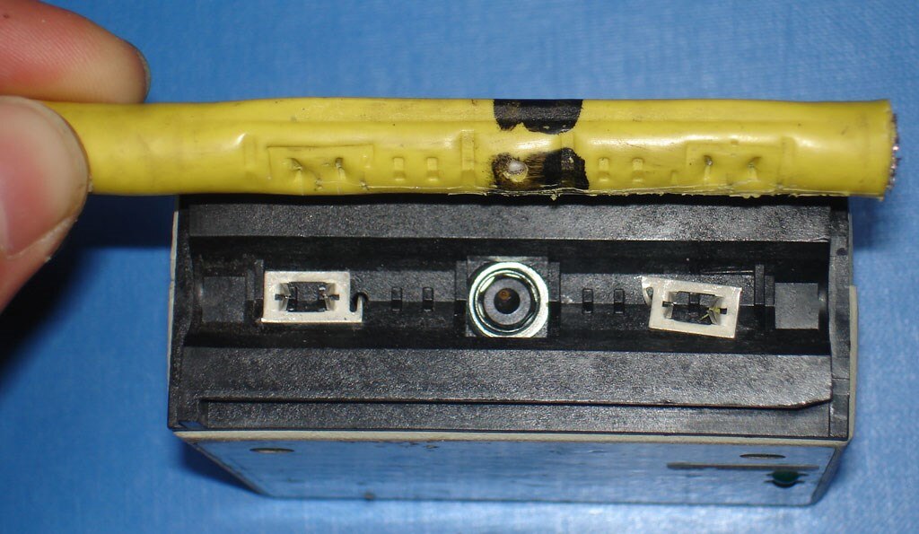

    Hey Shabaz! This is something new for me too. I never saw this kind of probes-connectors. Seems almost complex to build but also seems very efficient. The piercing approach of these probes resembles me the 80's network coaxial cables. It was possible to connect computer converters like network to centronics or serial using the tap-drill method. But I never saw something like this for decades.

    shabaz over 6 years ago in reply to balearicdynamics
    Hi Enrico!
    Very interesting.. I've never seen these vampire taps for networks before, but had heard of them. You're right, this probe seems a similar idea!
    The first place I worked had a ton of serial interfaced terminals (like VT100) but I don't know how the connection got to the desks. They were phasing it all out for PCs, but lots of work was still done on the terminals (like inventory, etc).
    The serial terminals went to a VAX machine. I remember using a word processor called Lex.
    balearicdynamics over 6 years ago in reply to shabaz
    Lex is a famous editor Shabaz! I remember it too. These vampires are really Jurassic IT. These were used with the 1-inch diameter IBM coax cable. I saw them on AS400 and in the first data center where I worked but whey was using IBM360 10 base 5 networks, data tapes and punched cards to schedule the jobs with JCL (The IBM Job Control Language).In that period terminals was Hazeltine and VT100 arrived some year later, with the 3200Kb modems and BBS, at least in Italy. This system was very efficient because it was possible to make a connection everywhere there was one of these main cables around.
    Some more details can be found hereç https://en.wikipedia.org/wiki/10BASE5
