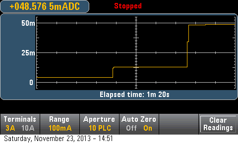

The STM32F4 has four main power modes - run, sleep, standby and stop - with the discovery board having a specific jumper designed to measure the microcontroller’s power consumption.
The first mode I tested was sleep. The microcontroller was programmed, then held in reset for the first 30 seconds of the recorded data. It was then released from reset, where the programmed software would immediately place it into sleep. After another 30 seconds, the microcontroller was woken up, by pressing a button, with the microcontroller illuminating four LEDs to indicate that it is awake.
The image below shows the trend chart on the multimeter.
The image above is a plot of the data, with annotations showing the different modes and the average current draw for each mode (with averaged 1-year errors).

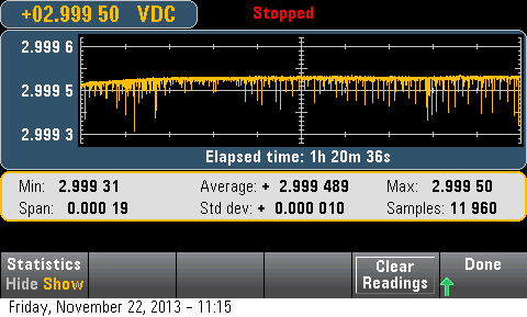

The first reference I characterised was one of the highest accuracy references I could get my hands on - Maxim Integrated’s MAX6126. This is a +/- 0.02% reference with a temperature coefficient of less than 3 ppm/ deg C, so should ideally be quite stable. The 34461A was set to auto-trigger and auto-range, with 10 PLC, and was left for around an hour and a half to warm up. Just for the sake of intrigue, I left the multimeter recording for this warm-up time, with the following images being the results.
Whilst practically not being very useful, it is quite interesting to see, from the trend graphs, the warm-up characteristics of the system - whether this is the multimeter or the voltage reference, is something that I have not looked into, as both had power applied to them at the same time.
The multimeter was then left for 9 hours measuring the voltage reference at the default rate (once every 200 ms). With the following images being taken from the multimeter.
One of the things that I particularly like about the multimeter is its programmability, which means that the user can directly access the histogram data from a computer. Whilst I will cover this in a later blog post, I thought I should mention that the histograms I obtained from the multimeter was done over the LAN interface using a Python script on my computer.
The first graph shows the exact same data as what is in the previous image, just with a slightly higher amount of detail.
The following image shows the same data again (on the same x-axis) but with a log frequency axis, to show the infrequent readings with a greater detail. Additionally this graph has three vertical lines, which, from left to right, are the 1st quartile, the mean and the the 3rd quartile. This essentially shows that half of the data is contained within the two bins enclosed by the outermost red lines.
As the measurements are temperature sensitive, it also makes sense to show a graph of the temperature for the same 9 hour period. For almost a year now, I have had a raspberry pi collecting temperature measurements on a per minute basis. This uses an Analog Devices' ADT7410, which has an accuracy of +/- 0.5 deg C. The following graph shows a histogram of the temperature over the 9 hours, with the red lines indicating the same as before.
As the 34461A records the minimum, maximum and mean, we do not have to infer this from the histograms, with the values for 80,156 measurements being,

With the voltage reference having an accuracy specification of 0.02%, we can see that the minimum value measured is worse than what it should be, however this does not mean that the reference is operating outside its specification. On average the reference is within its 0.02% specification with a value of approximately 0.0169%, this can be trusted to a high degree due to the number of readings that have been averaged. Although this value will have some level of computational error in it, as the 34461A uses floating point maths for calculating statistics.
The first thing to consider is whether the accuracy is reduced due to the temperature of the reference. The temperature, measured by the ADT7410, had a minimum of 19.007812 deg C +/- 0.5 deg C and a maximum of 20.101562 deg C +/- 0.5 deg C. As the MAX6126 is specified for 25 deg C, the maximum temperature difference is almost 6 degrees. This affects the accuracy of the reference by 0.00179766 % +/- 0.000150000 %. With all the errors adding together to reduce the figure, the lowest the minimum value could possibly be is 0.0223580 %, which is still outside the specification.
It is also possible that the accuracy has been diminished by another factor. From the 34461A's tend graph, there are spurious negative spikes that were quite unexpected. To get the voltage reference as physically close to the temperature sensor as possible, the reference and multimeter were placed in close proximity to a wifi router, which may have added additional noise to the measurement. Additionally, as the voltage reference was hand soldered, it is possible that the accuracy of the reference might have been decreased due to thermal shock (i.e. too high of a temperature), however, I would have expected this to consistently decrease the accuracy of the sensor, rather than produce the observed spurious spikes.
