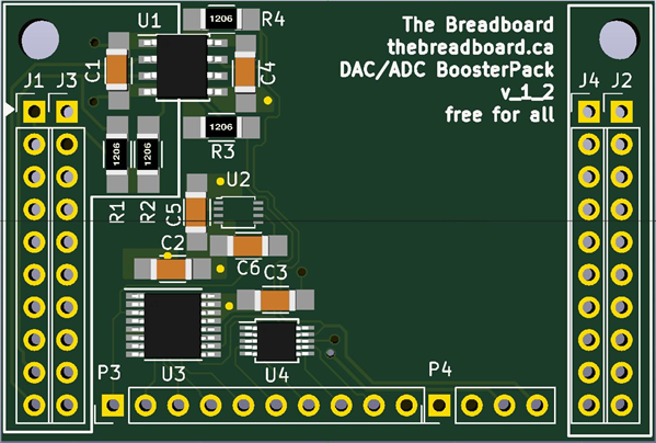

This post documents the ADC firmware for the electronic load we made here on element14.

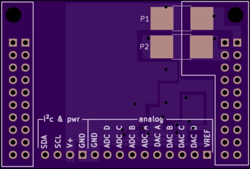

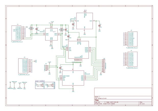

The DAC-ADC BoosterPack
Output pin assignments
All pins isolated from LaunchPad if P1 and P2 open.
P1 and P2 are for BoosterPack testing only, to deliver power to the DAC, ADC and REF ship when no power board is connected.
In the final design, P1 and P2 need to be open and the power board has to provide GND and V+ for these 3 ICs.
It should be at least 3V (ISO min. VCC2 requirement) and max 5V5 (max rating for ADC). Let's use 3V3 to 5V.
PinDirNameDescription
P3.1analog outVREFfuture
P3.2analog outDAC Dfuture
P3.3analog outDAC Cfuture
P3.4analog outDAC Bfuture
P3.5analog outDAC Acurrent control voltage
P3.6analog inADC Aactually set current readback
P3.7analog inADC Bsense voltage at device under test or terminals
P3.8analog inADC Ctemperature
P3.9analog inADC Dfuture
P3.10depends on P2GNDshould come from power board GND if we run isolated (P2 open)
P4.1depends on P2GNDshould come from power board GND if we run isolated (P2 open)
P4.2depends on P13V3should come from power board if we run isolated (P1 open). 3V3 - 5V
P4.3digital outi²C SCLfuture
P4.4digital in/outI²C SDAfuture

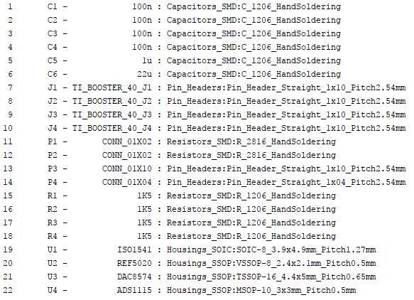

BOM for pcb version 1_2:
Changes between versions of the ADC/DAC pcb:
protopackageV1_1packageV1_2package
oshparkseeedseeed
ISO1541DRISO1541DR8-SOICISO1541DRISO1541DR8-SOICISO1541DRISO1541DR8-SOIC
REF5020IDREF5020ID8-SOICREF5020AIDGKTREF5020AIDGKT8-VSSOPREF5020AIDGKTREF5020AIDGKT8-VSSOP
DAC8571IDGKRDAC8571IDGKR8-VSSOPDAC8571IDGKRDAC8571IDGKR8-VSSOPDAC8574IPWDAC8574IPW16-TSSOP
ADS1115IDGST10-MSOPADS1115IDGST10-MSOPADS1115IDGST10-MSOP

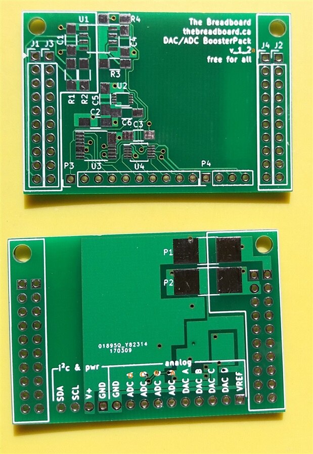

bodge
  U3 Vsense to VOUT
U3 Vsense to VOUT
ADCs labeled reverse on the PCB.
D=A, C=B, B=C and A=D
Solder advice: in hindsight I should have used larger IC packages. The board isn't easy to solder at home. But it's doable with proper care, hand stability of a snooker player and eyesight of an eagle.
It's best to leave capacitor C5 off and solder it separately when the other components (in particular U2) are mounted. Even then it may be good to move it as far as you can from U2's pins. I didn't provide enough clearance in my PCB design.
The VSSOP footprint of U2 is narrow on the V1_2 board. If you are brave, you can use pliers to bend the pins a bit down. I cut of the pins 5, 7 and 8 with a hobby knife.
