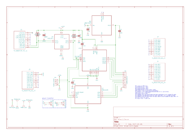

This blog documents the characteristics of the DAC/ADC BoosterPack of the electronic load that Robert Peter Oakes, jc2048 and Jan Cumps are designing.
We have the same DAC/ADC BoosterPacks so we can compare the measurements of each ADC and DAC channel. Check the main document for anything related to hardware and firmware.image

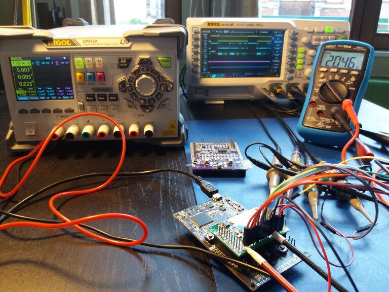

Test Setup

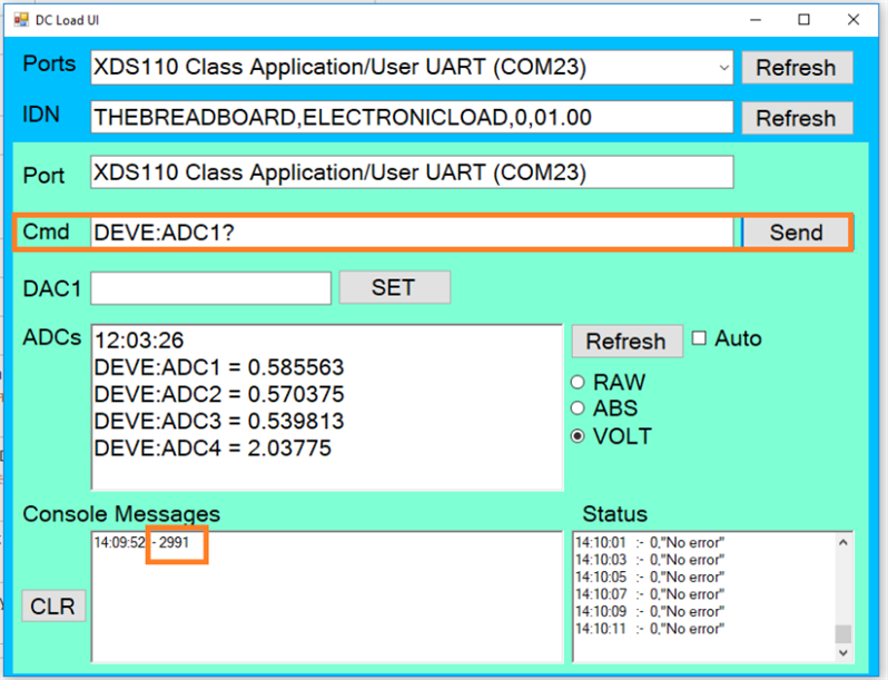

Peter has created a GUI that we can use to shoot SCPI commands. We can control the DACs and read the ADCs.
Measurements are performed with and without the power driver BoosterPack installed. We'll use 5V to power the DACs and ADCs in both situations.
image P1 and P2 on the bottom of the DAC/ADC BoosterPack have to be open. Else you'll inject 5V onto the LaunchPad 3V3 rail and you'll damage components.
It's not critical if you switch on the power supply before or after you connect the LaunchPad to your computer. The circuits are isolated.
All measurements use P3.10 as GND reference and P3.1 as reference voltage.
Setup without the power driver BoosterPack:
Mount the DAC/ADC BoosterPack on the LaunchPad.
Use a +5V power supply. It should be a decent one, current is approximately 5 mA.
Connect image with DAC/ADC BoosterPack P4.2  and image with P4.1.

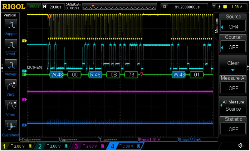

To resolve
With the power driver installed, ADC C and D act strange (probably also A and B, but I didn't inject a voltage in them because they are connected to opamp pins).
In particular strange for ADC D, because that one isn't routed. Strange.
I will try to decrease the frequency of the sample speed and the i²c speed to see if it's related to that ...
Follow up: the cause is that OPAMP 3C injects -0.8V into ADC A. All measurements are off when that happens. As soon as I force ADC A positive (by tying it to ground or a positive voltage) all measurements are correct.
