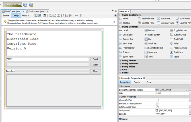

I want to start with a layout because it's easier to dry-run that and see if it would be up to the job when there isn't any application logic yet.
In this case, I used the NetBeans IDE's (see next section for more info) graphic designer to lay out the application.

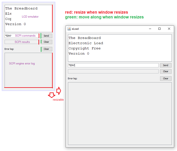

Like most Java dialog designers, it lets you place elements on the window frame and choose what objects stay fixed, who moves and who resizes if the window size changes.
You can see below how I want the application to behave upon resize:

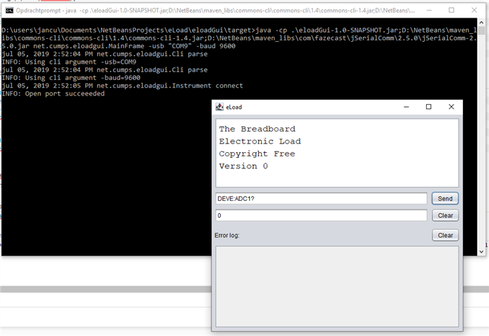

Here you can see the first iteration in action. The video is edited for brevity, but all actions are real.

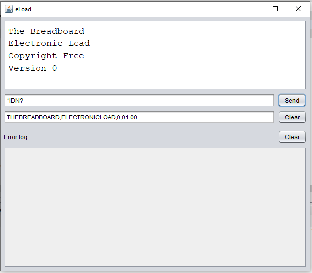

The intended functionality:
  • the top frame emulates the LCD screen on the eLoad. It should always display the same info as the physical screen on the instrument. No user interaction.
  • then four controls that work together: the SCPI command line interface.
    • a command entry box with send button. When you click the button, the command in the entry box is sent to the instrument
    • then the instrument reply is read and the result shows in the text display button
    • the clear button empties the reply display.
  • at the bottom, the error log. Here, SCPI engine errors will be displayed. At this moment, I plan to only call this when you submit a command.
    The clear button next to it clears the log.
  • GUI and instrument functions separated. GUI should only ask and retrieve.
Functionality in this blog: the layout done and SCPI command + response working. Separate object to handle instrument logic.

The layout is done with the graphic editor.
I then added initialisation code.

Then I create event handlers for the Send and Clear button.
    private void jButtonSCPISendActionPerformed(java.awt.event.ActionEvent evt) {
        instrument.write(jTextFieldSCPICmd.getText() + '\n');
        String s = instrument.read();
        jTextFieldSCPIReply.setText(s);
    private void jButtonSCPIResultClearActionPerformed(java.awt.event.ActionEvent evt) {
        jTextFieldSCPIReply.setText("");

    The app now is usable:
    • LCD display works. Shows mode, status, set value, measured current and voltage.
    • Input on/off button
    • Set constant current
    • Error logging. Button turns red and shows error count. Clicking the button retrieves the errors.
      Clicking the button when it's green (0 errors waiting) clears the log
    • SCPI command inteface to second tab.
    You can see a bug in the resize logic. By accident I let the LCD screen resize vertically. It should be the Error Log that resizes. I've fixed that.
