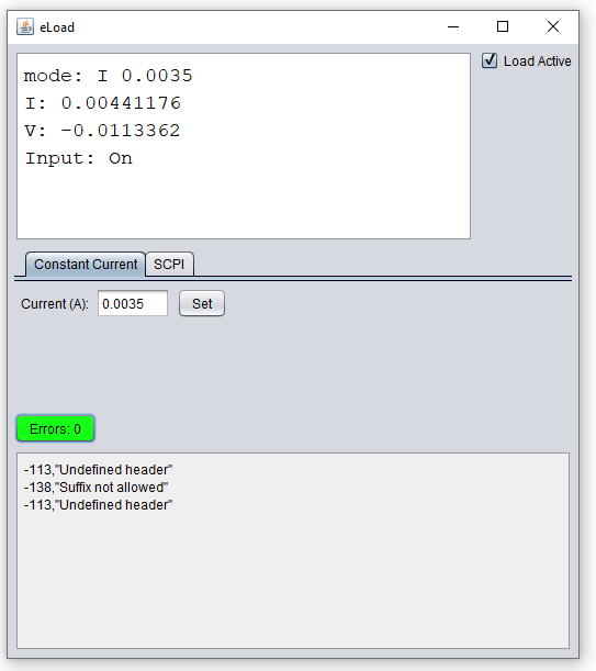

Retrieve Instrument Status: Multiple SCPI Commands Combined
The screen refreshes the GUI controls based on the instrument status.
  • LCD display displays mode, set current, measured current and voltage, input on/off status.
  • "Load Active" checkbox reflects the current status of the input (you can also change the status with it.
  • Errors button shows the number of errors captured by the instrument. If there are unretrieved errors, it shows the count and turns red.
There are a number of SCPI commands required to get that info.
To avoid many back-and forths, and to minimise the time that the instrument is locked for other SCPI commands, all queries are combined in a composite SCPI statement.
INP?;FUNC?;CURR?;:MEAS:CURR:DC?;:MEAS:VOLT:DC?;:SYST:ERR:COUNT?

Then the GUI components are updated.
        // update LCD display
        jTextAreaLCD.setText("mode: "
                + (String) (refreshData.sMode.startsWith("CURRent") ? "I" : "*ERROR*")
                + refreshData.sSetValue
                + "\nI: " + refreshData.sI + "\nV: " + refreshData.sV
                + "\nInput: O"
                + (String) (refreshData.bActive ? "n " : "ff"));
        // update Input Active control
        jCheckBoxInputActive.setSelected(refreshData.bActive);
        // update error count
        jButtonSCPIErrorClear.setText("Errors: " + refreshData.sErrCount);
        if (refreshData.sErrCount.startsWith("0")) {
            jButtonSCPIErrorClear.setBackground(Color.green);
        } else {
            jButtonSCPIErrorClear.setBackground(Color.red);

Switch Load Input On and Off
There's a checkbox that you can use to enable and disable the load.
In the first section you saw that it shows the current state of the device.
But it's an active control. By checking and unchecking it, you control the instrument's output.
You'll also see this reflected in the LCD display (after the next timer event).
    private void jCheckBoxInputActiveActionPerformed(java.awt.event.ActionEvent evt) {
        String s;
        s = "INP " + (jCheckBoxInputActive.isSelected() ? "ON\n" : "OFF\n");
        synchronized (instrument) {
            instrument.write(s);

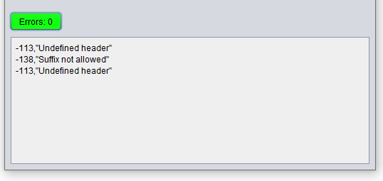

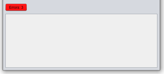

Error Handling
Each refresh, the timer checks if there are errors logged on the instrument.
If not, it colours the Error button green and labels it with "Errors: 0".
If there are errors, the button colours red and the number of errors are shown.
You can click the red button to retrieve the error messages into the log.
Upon that action, the button turns green again and shows "Errors: 0".
That's because the action of retrieving an error removes it from the instrument.
We retrieve all errors, so the backlog is clean.
Clicking that green button clears the error log on screen.
How can you get errors when using the GUI:
  • enter an invalid value for the constant current (a character, an under/overflow)
  • enter a wrong or unsupported SCPI command in the SCPI tab (the log shows different messages for wrong vs. unsupported)

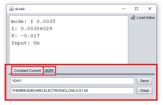

TAB for Constant Current Controls and SCPI Command Prompt
To avoid clutter, and to present a simple interface by default, I used a TAB control where you can switch between Constant Current and SCPI control.
You can mix and match the two ways of controlling. The instrument doesn't know whether you used a button or typed a command .
Neither does the interface, once you did the action.
So there are no side effects (except when you use the debug level :DEVELOP: SCPI commands to directly control the DACs).
Minor improvement: when you press enter in an edit box, it performs the same task as the Send button next to it.
It avoids that you have to switch between keyboard and mouse.
