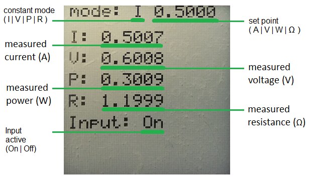

The Layout

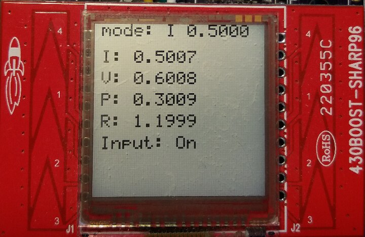

The LCD shows the mode, status, set and measured values.

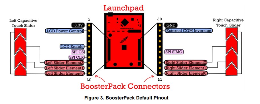

The optional display is a boosterpack, Product LinkProduct Link. The load doesn’t need the display to operate.
It was added for two reasons: it served as a debug tool at the beginning of the project when the SCPI commands weren,t implemented.
And it’s a test case to ensure that presentation layer is independent of instrument code.
Both SCPI module and display use the load’s api to control and query the app.

Main Schedule
The loop is run once per second. It displays the constant mode, the current, voltage, power and resistance.
