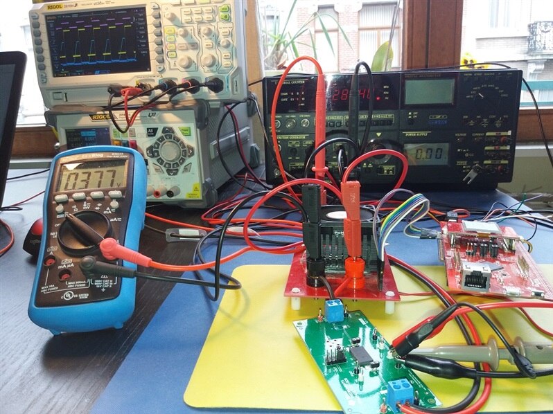

Test Points
I've wired the main points of the control circuit - an opamp integrator:
  • the inputs of the integrator (set point and measured feedback)
  • the output of the integrator
  • the gate of the power mossfet.
This should be enough to get a view into the dynamics of the circuit. In hindsight I could have also captured the inverting input of the integrator but I didn't.
