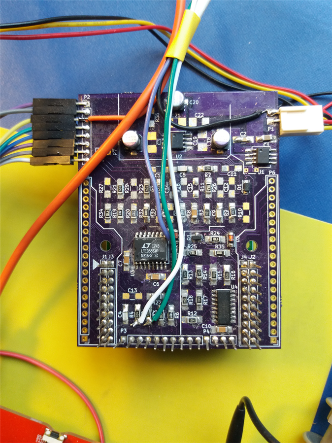

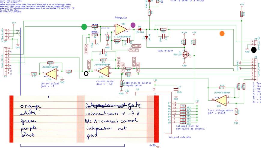

Test Points
I've wired the main points of the control circuit - an opamp integrator:
  • the inputs of the integrator (set point and measured feedback)
  • the output of the integrator
  • the gate of the power mossfet.
This should be enough to get a view into the dynamics of the circuit. In hindsight I could have also captured the inverting input of the integrator but I didn't.

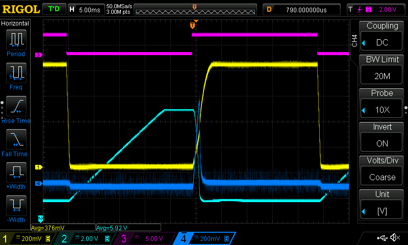

First Setup: Square Wave input signal.
jc2048 has documented the behaviour using a simulator. One of the exercises was the reaction of the controller circuit on a square wave input.
Programmable Electronic Load: Dynamic Behaviour: Part 1 Overview

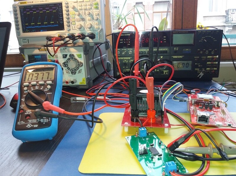

I've replicated this by passing a pulsed 0.6 V signal to the dc load and try to keep the current to 200 mA.
On the captures below, the
  • yellow signal is the square wave 0.6 V 20 Hz input voltage to the dc load.  It isn't a perfect square because there is output capacitance on supply.
    (I don't have a square wave generator that can be loaded, so I used the TI SWIFTTm Power Module EVM module from the RoadTest I did a while ago and pulsed the output via the EN signal)
  • purple is the TTL 20 Hz signal that I used to pulse that voltage.
  • light blue is the gate voltage to of the mosfet.
  • dark blue is the measured current, taken after the opamp. Inverted because the opamp has a negative gain.

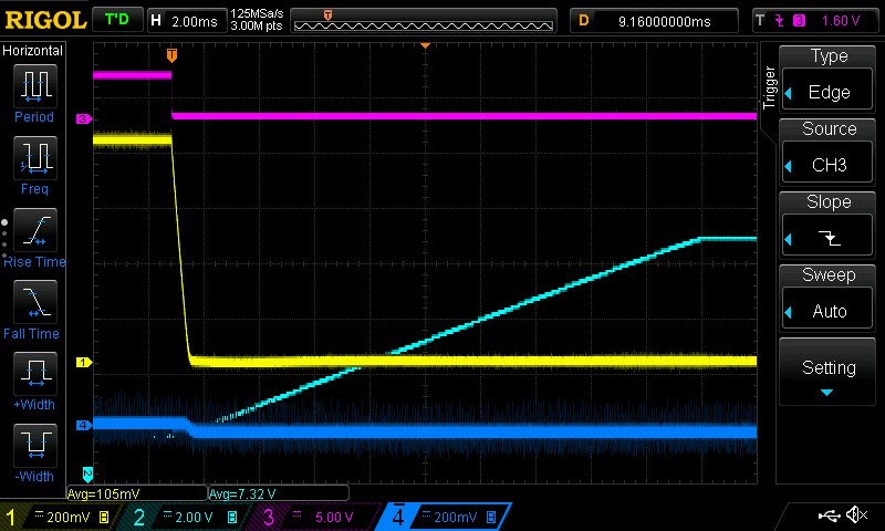

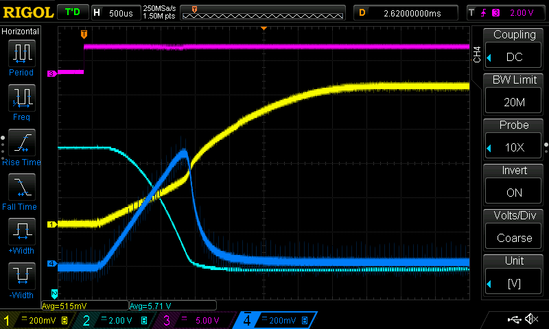

The first capture shows a complete cycle:
The next one is triggered on the rising edge:
The last one is triggered on the falling edge:
That's it for this blog. It's more food for thought than actually analyzing what's happening. I think it shows enough info to start a discussion though.
