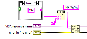

This blog documents focuses on the SCPI functionality of the electronic load that Robert Peter Oakes, jc2048 and Jan Cumps designed.
The interface works with software that can do serial communications on a COM port.
This project comes with a LABView driver and 2 proto GUIs.
