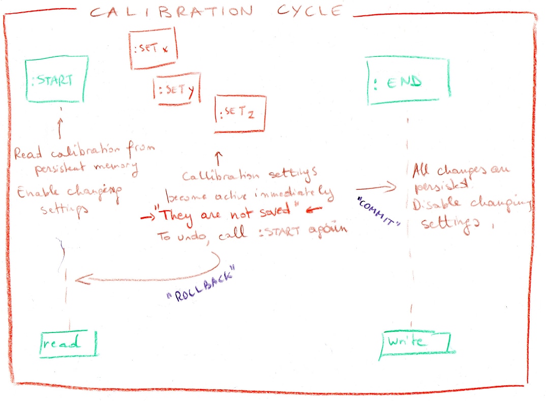

Calibration and configuration are done via SCPI commands.
You init the calibration session, perform steps and close the session.
While a calibration session is active, any changes made to the calibration settings are active but not saved.
At session closure, calibration data is stored on the device.

Opening sequence
CALibration:STArt
Inform the device that a calibration/configuration session starts.
If you don't do this, any other calibration "set" command will throw an error and no changes will be applied to the instrument's calibration data.
The Clear and *RST commands aren't implemented.
I'm not sure yet if the Clear command is desired or needed.
There's no discussion on the *RST command, we'll have to implement that at some time to put the device in a known state.
CALibration:STArt ...
CALibration:Clear ... // NOT implemented
*RST
Calibration sequence
When a session is opened, you can start using calibration "set"  commands. "Query" commands also work without a session opened.
If used without a session, they will return the stored values. If used in a session, they reflect whatever changes are done during the session
CALibration:SET ...
CALibration:MEAs ...
Closing sequence
CALibration:END
The End comment saves the settings to the device. As long as you don't call this command, no changes are permanent. They will only stay active as long as the device isn't reset or power cycled.
If you want to undo any changes and start over again, call the Start function again.
If you want to cancel the exercise, power cycle the device.
CALibration:END  ....

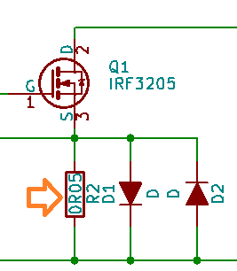

Configure the Current Sense Resistor
Two API functions are available to set the sense resistor value:
CALibration:SENSEResistance
CALibration:SENSEResisitance?
The value related to this function is the resistance of the sense resistor R2 on the MOSFET board.
Get the Sense Resistor setting:
CALibration:SENSEResistance?
This function will return the resistance of the current sense resistor as stored in calibration data.
Example:
0.05
Set the Sense Resistor setting:
CALibration:SENSEResistance [NUMBER]
This function will set the resistance of the current sense resistor in the calibration data.
Example:
CALibration:STArt
*RST
CALibration:SENSEResistance 0.05
CALibration:END
Error: throws SCPI_ERROR_EXECUTION_ERROR if there is no active calibration session
Error: throws SCPI_ERROR_ILLEGAL_PARAMETER_VALUE if you set the value to 0.

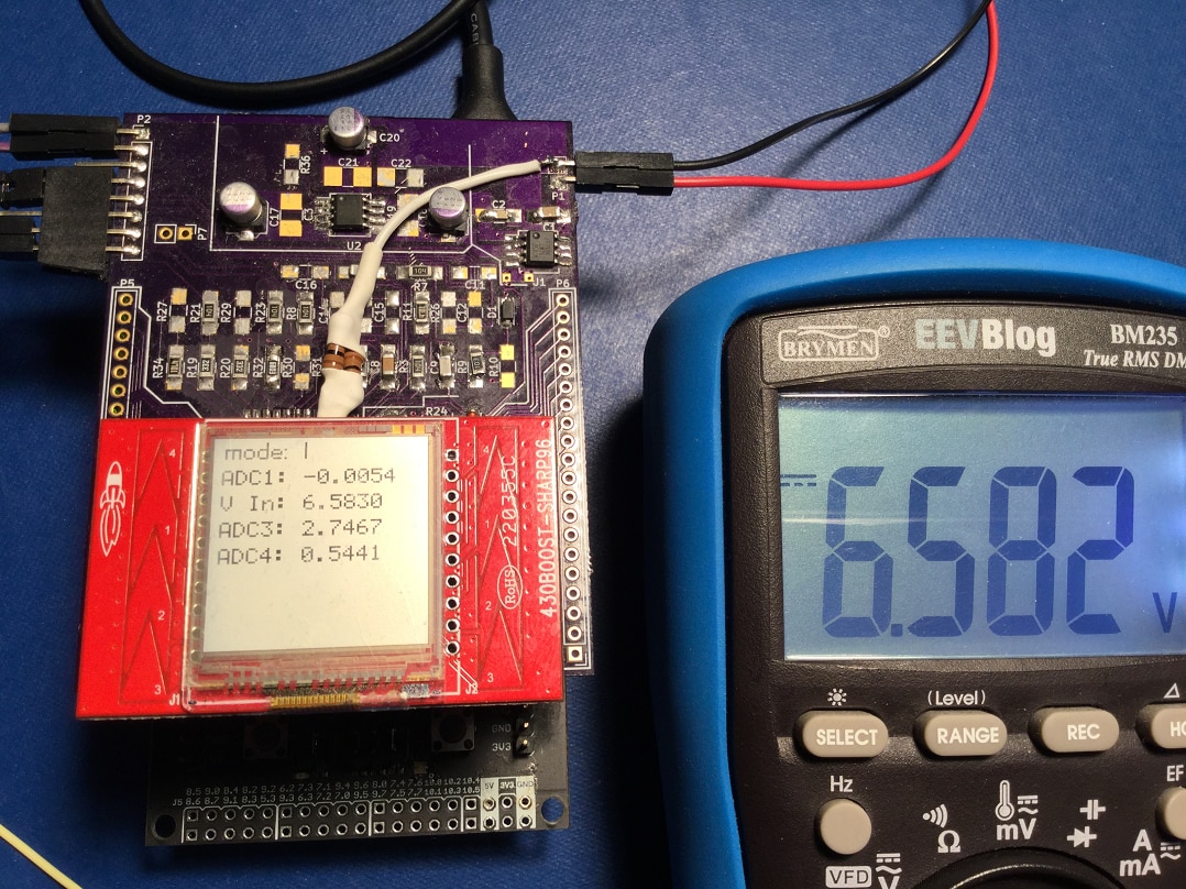

Configure the Input Voltage Sense Read Correction
Five API functions are available to correct the Input Volage Sense measurement:
CALibration:SENSEVOLTREADOffset
CALibration:SENSEVOLTREADOffset?
CALibration:SENSEVOLTREADMultiplier
CALibration:SENSEVOLTREADMultiplier?
CALibration:ADC2:VOLT?
The offset is the DC component measured by the ADC when the sense inputs of the instrument are shortcut.
The multiplier is the gain in the circuit between the sense inputs and the ADC.
The input voltage sense signals are measured by opamp U3D.
This opamp has a gain of 0.033. It divides the voltage by 33.3333333.
That value is then sampled by ADC 2.
To show the correct voltage at the sense inputs, we have to multiply the sampled value again by theoretically 33.3333.
To correct for the tolerances of the input circuit, the instrument allows you to fine tune this offset and multiplier.
It requires a calculator and a reference voltage.
To correct the offset, shortcut the sense inputs of the load.
That should give us a value at the ADC of 0 V.
Then check the voltage of the ADC 2, using CALibration:ADC2:VOLT?. This returns -0.0057 V in my case.
We use CALibration:SENSEVOLTREADOffset to store this measurement in Flash. All future measurements will take the offset into account.
Start a calibration session with CALibration:STArt and configure the multiplier with CALibration:SENSEVOLTREADOffset -0.0057.
Check if the value is accepted with CALibration:SENSEVOLTREASOffset?.
When OK, close the session and save the settings by calling CALibration:END.
To correct the multiplier, provide a precise voltage at the voltage sense inputs. If you have a voltage reference (there is one on the ADC/DAC board), you can use that. Else use a power supply and a reasonable DMM.
I use a lab power supply and set it close to the maximum voltage that gives 3 digit precision on my DMM:  6.583. The DMM is connected on the same voltage sense inputs
Then check the voltage of the ADC 2, using CALibration:ADC2:VOLT?. This returns 0.218063 in my case.
The multiplier for my board is 6.583 / 0.218063 = 30.188523500089423698655893021741.
Start a calibration session with CALibration:STArt and configure the multiplier with CALibration:SENSEVOLTREADMultiplier 30.188523500089423698655893021741.
Check if the value is accepted with CALibration:SENSEVOLTREADMultiplier?.

    Jan Cumps over 8 years ago +3
    I've added SCPI functions to calibrate the input voltage measurement. The code is available in github . The LCD display shows the sense voltage. I haven't implemented the SCPI function yet to return the…

    I've added two calibration functions for the current sense resistor.
    This serves two goals. If you want to use a different resistor, the firmware now can handle that. And if you have a precision ohmmeter, you can store the measured value in the calibration data.
    The calibration commands for sense voltage and current measurement corrections are implemented.
    Each has an offset command to deal with DC offset measured at the ADC at 0 level, and a multiplier command to reflect the actual gain of the opamps between the measurement point and the ADC.
    Documentation for the Sense Voltage is finished in the document above. I have to do the same for current.
    I've added SCPI functions to calibrate the input voltage measurement. The code is available in github.
    The LCD display shows the sense voltage. I haven't implemented the SCPI function yet to return the value.
    The SCPI command to get the input voltage sense is:
    MEASure:VOLTage:DC?
