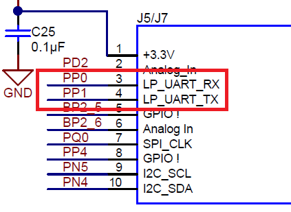

Info: initial design used UART1 as 2nd option. When switching to the Red MSP432 LaunchPad, this switched to UART6.
Where you see UART1, think UART6.
UART module if USB UART0
9600/8/1/N
UART module if TTL UART6
115200/8/1/N

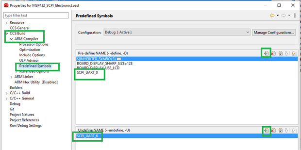

compile option to choose the UART:
SCPI_UART_0
SCPI_UART_6
Undefining SCPI_UART_6 and defining SCPI_UART_0 enables UART0 (USB debug port)
Undefining SCPI_UART_0 and defining SCPI_UART_6 enables UART6 (TTL 3V3)
It allows to select the port without code changes.
