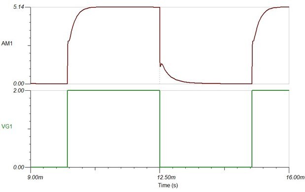

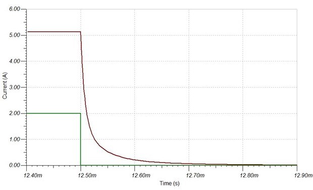

Just as a reminder, here's the original waveform with C2=4.7nF and C3=100pF

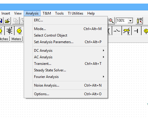

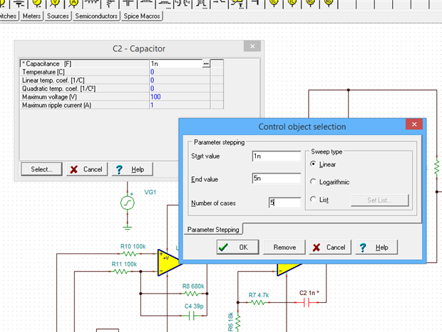

To put the simulator into the mode where it will step parameter values, I click on "Mode..." in the Analysis menu

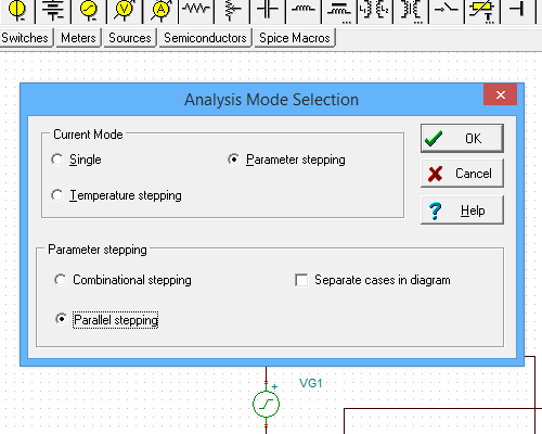

That then brings up the Analysis Mode Selection box. I select 'Parameter stepping' as the Current Mode. The other selection 'Parameter stepping' can be either - I'm only working with one parameter at the moment (that selection controls how the software operates when there is more than one control object).
I then go back to the Analysis Menu, click on 'Select Control Object', and then click on C2 with the modified cursor that comes up; then I select the '...' next to the parts value in the dialog box that comes up; then I enter the parameter stepping values in the 'Control object selection'. Here I put in a start value of 1nF, an end value of 5nf and asked for 5 linear steps, so I'll get traces for 1nF, 2nF, 3nf, 4nF, and 5nF.

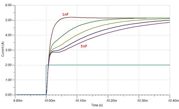

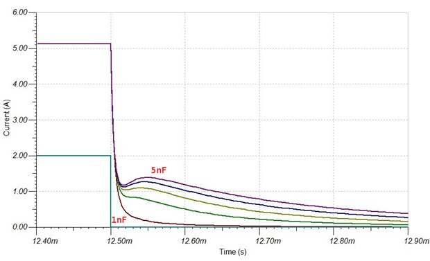

Here's the resulting trace when I run a transient analysis for the leading edge of the input. The different colour curves are for each of the different component values. In the software you can click on an individual curve and the parameter(s) will be reported on the status bar at the bottom. For this blog, I annotated them afterwards using Gimp.
Here's the trailing edge.
I love these. They show beautifully the way in which the waveform shape changes and the sensitivity of the circuit to the value. Here we can see that the waveform shape is much better with a 1nF capacitor than it was with the original 4.7nF.

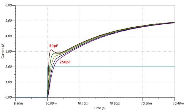

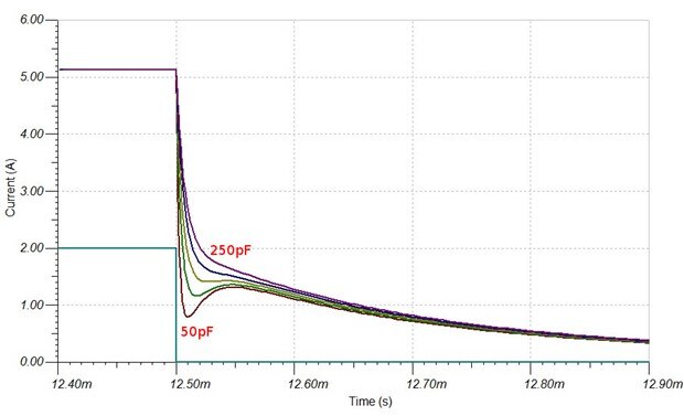

Now I'm going to try varying the value of C3 with C2 set back to the original value of 4.7nF. Here are plots for C3 from 50pF to 250pF in steps of 50pF
This shows the way that the differentiator holds back the rapid change and counters the overshoot.

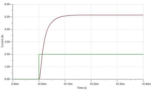

It's evident from these two experiments that I need to adjust C3 first, and then use C2 to correct for any overshoot. Here are the rise and fall waveforms with C2 set to 1n and C3 set to 220p
that's about the best I'm going to do without changing other values. It looks like it will raise the large-signal bandwidth from several hundred Hz to a couple of kHz. One thing that's evident from the waveforms is that the fall is different to the rise. That's evidently due to the non-linearity of the MOSFET down at the bottom end - where the control voltage needs to move further towards the end of turning off than it does towards the end of turning on, but is limited in the rate at which it can move. This is the point at which we're starting to move away from simple servo-loop theory which assumes the system is linear.
