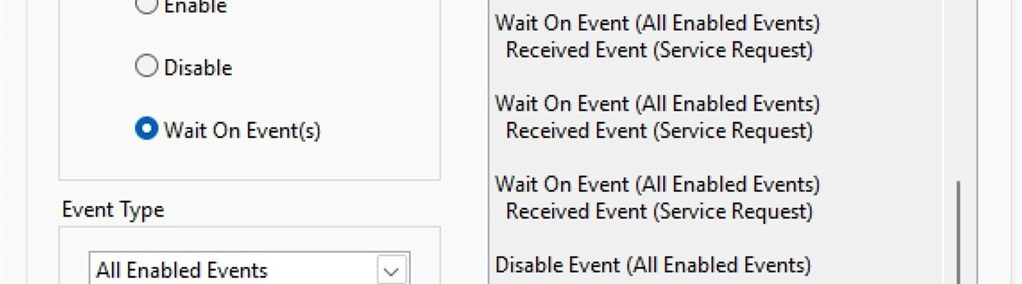

Test SRQ with NI VISA Interactive Control
Let's first bring the device in the condition that button presses fan out to OPERATION STATUS EVENT register, and propagate all up.
STATus:OPERation:DIGItal:INPut:NTRansition 4\n
STATus:OPERation:DIGItal:INPut:ENABle 4\n
*CLS\n
STATus:OPERation:ENABle 1\n
Enable propagation by setting SRE Bit 7 (OPER Bit) to 1
*SRE 128\n
test 1: Register the Event Handler and prime. Request should time out because we don't generate the event that it's waiting for.
condition:
  1. Enable Service Request Event handling
    image.
  2. Wait on the event with a 2 second timeout. Don't push the button. This should generate a timeout.
  3. Wait on the event with a 2 second timeout. Push the button within those 2 seconds to generate the event.
result:
Result when button is not pushed while we wait for the event:
Result when button is pressed within the timeout:
pass
