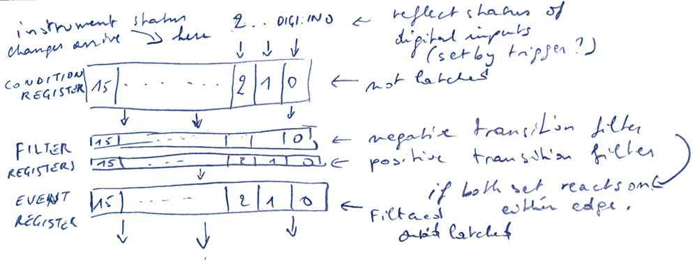

I designed a user condition, event and enable register, with the OPERATION STATUS register as parent.
  • I can change values in the condition register.
  • the value trickles and  latches in the corresponding bit in the event register
  • the value trickles down to a bit of my choice in the OPERATION STATUS register (also latched)
That means that I can listen to GPIO, and set a condition register bit. Library infra will manage the latching and clearing
I designed 2 additional registers to indicate if I want to listen to positive and/or negative transitions. The latching will only apply if the transition is requested to be monitored.
All is handled by the lib. It seems that I only have to define the user registers, configure the behaviour. And that results in changes in the standard OPERATION STATUS register.
Existing SCPI commands in the lib can take care that these trickle down further to standard OPERATION bit of the STATUS BYTE register

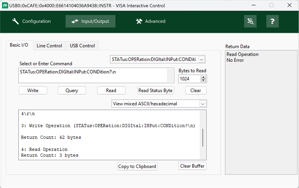

    All required SCPI commands are now implemented:
        // instrument specific registers commands
        {.pattern = "STATus:OPERation:DIGItal:INPut:EVENt?", .callback = SCPI_StatusOperationDigitalInputEventQ,},
        {.pattern = "STATus:OPERation:DIGItal:INPut:CONDition?", .callback = SCPI_StatusOperationDigitalInputConditionQ,},
        {.pattern = "STATus:OPERation:DIGItal:INPut:ENABle", .callback = SCPI_StatusOperationDigitalInputEnable,},
        {.pattern = "STATus:OPERation:DIGItal:INPut:ENABle?", .callback = SCPI_StatusOperationDigitalInputEnableQ,},
        {.pattern = "STATus:OPERation:DIGItal:INPut:PTRansition", .callback = SCPI_StatusOperationDigitalInputPTransition,},
        {.pattern = "STATus:OPERation:DIGItal:INPut:PTRansition?", .callback = SCPI_StatusOperationDigitalInputPTransitionQ,},
        {.pattern = "STATus:OPERation:DIGItal:INPut:NTRansition", .callback = SCPI_StatusOperationDigitalInputNTransition,},
        {.pattern = "STATus:OPERation:DIGItal:INPut:NTRansition?", .callback = SCPI_StatusOperationDigitalInputNTransitionQ,},
    Test with NI Visa Interactive
    output:
    # button not pressed: input 27 (bit 3) high
    1: Write Operation (STATus:OPERation:DIGItal:INPut:CONDition?\n)
    2: Read Operation
    4\r\n
    # button pressed: input 27 (bit 3) low
    3: Write Operation (STATus:OPERation:DIGItal:INPut:CONDition?\n)
    4: Read Operation
    0\r\n
