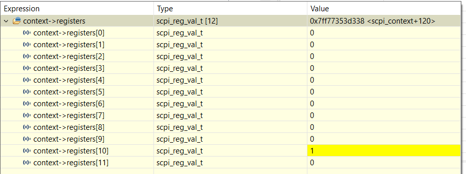

    Trying to set a bit in my user register. Should (hopefully) trickle through to *STB
    It is setting the value of my user register, that's a start ...

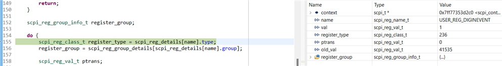

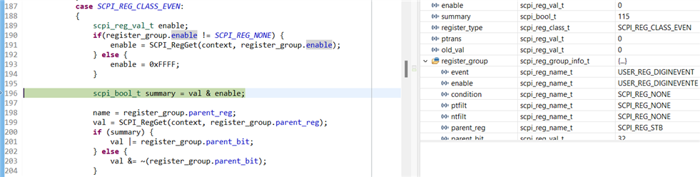

    Debugging further, I see it doesn't trickle through:
    It makes sense. I did not set the bit in the enable register ... I'll rewrite the example, set the enable bit, then change the value ...
        SCPI_RegSet(&scpi_context, USER_REG_DIGINEVENTE, 0x01);
        SCPI_RegSet(&scpi_context, USER_REG_DIGINEVENT, 0x01);
    Rerunning ...
    This looks like it 'll work. It detected the enable setting, and set the summary flag true. That should trigger the trickle down to *STB...
