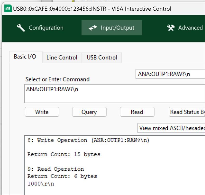

Using It
The Pico SCPI labTool (PST) is quick. I plugged the USB connector from the Pi Pico into the PC, and it was detected by the driver software before I’d even let go of the plug!
I happened to have Tektronix software installed, which includes VISA code, and it can access instruments. I clicked on the software and it allowed me to type SCPI instructions, and see the results!
Of course, Tektronix software is not necessary. You could install VISA directly from the National Instruments website.
Now you’re ready to try it out!
If you installed the NI software, then use a supplied tool called VISA Interactive Control, and select the PST as shown here, and double-click it:
A new window will open. Click on Input/Output and then type the following (it may be present as the default on startup anyway, in which case you don't need to type it!) and then press the button labeled Query:
*IDN?\n
You should see a response containing the text PICO-PI,LABTOOL.
Note: The NI Visa Interactive Control will require the user to type \n on the end of each command, whereas some tools such as the Tektronix one doesn't require that.
Now try typing DIGI:OUTP0 1 (followed by \n if you're using the NI Visa Interactive Control) and press the button labeled Write. If you have an LED soldered to GPIO 22 (pin 29) on the Pi Pico, it should light up!
