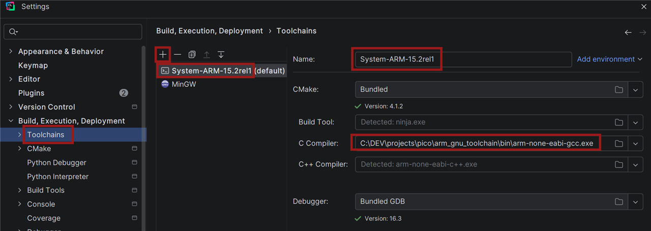

4. Install the ARM GNU toolchain; I decided to install in C:\DEV\pico\arm_gnu_toolchain so that in that arm_gnu_toolchain folder, I could see folders called arm-none-eabi, bin, include, lib and so on.
5. Create a User variable in Environment variables, called PICO_TOOLCHAIN_PATH, set to C:\DEV\projects\pico\arm_gnu_toolchain
6. Install CLion

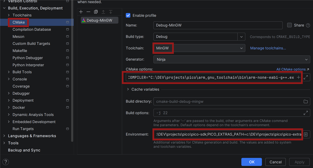

7. Go to the CLion Settings, navigate to Builds,Execution,Deployment->Toolchains and create a new toolchain and configure as shown in the screenshot; you can see I set the C Compiler to C:\DEV\projects\pico\arm_gnu_toolchain\bin\arm-none-eabi-gcc.exe
8. Navigate to the CMake settings, and configure as shown in the screenshot below. For the CMake options, I used the following: -G Ninja -DCMAKE_C_COMPILER="C:\DEV\projects\pico\arm_gnu_toolchain\bin\arm-none-eabi-gcc.exe" -DCMAKE_CXX_COMPILER="C:\DEV\projects\pico\arm_gnu_toolchain\bin\arm-none-eabi-g++.exe
For the Environment I used: PICO_SDK_PATH=C:\DEV\projects\pico\pico-sdk;PICO_EXTRAS_PATH=C:\DEV\projects\pico\pico-extras
Note that it is very key that the Toolchain selection is set to MinGW. That’s because a program called picotool gets downloaded during the build process, and it is a Windows application that will get built using MinGW’s gcc compiler that was part of the CLion installation. Granted it seems confusing since we want to build an ARM executable for the actual project code, but it definitely needs to be set to MinGW.
9. That’s it, now code should build. You could try to build any project you have. From the top menu bar in CLion, you may need to go to Tools->CMake->Reset Cache and Reload Project to clear out old settings for a project first. If all goes well, a folder called cmake-build-debug-mingw will appear in your project folder, and it will contain various files, but especially the .uf2 suffixed final built file, ready for uploading to a Pi Pico.

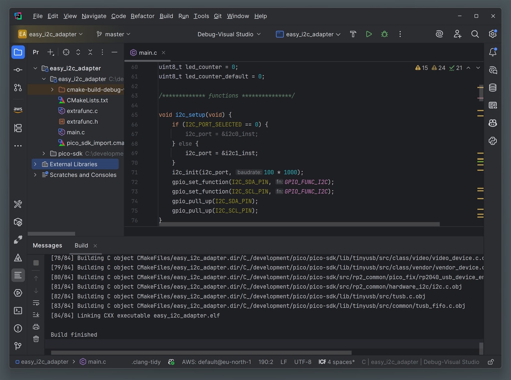

The screenshot below shows what the environment looks like while coding. The top-left pane shows the file names in the project, and double-clicking on a name will display the code in the right pane; that’s pretty standard.
I like that for each function call, CLion will display the description of the parameter as shown with the red arrows.
Another powerful feature is the Structure pane (go to View->Tool Windows->Structure to open it). It shows a kind of summary of what’s in the code file. I frequently look at that while coding, to recall the names of (say) global variables, or functions and their parameter types. It’s a huge time-saver.
A super-powerful keypress is Ctrl-B. If your text cursor is in any function or variable name in the code, pressing Ctrl-B will immediately either highlight where the variable was defined, or it will open up the file containing that function or variable in a separate tab. You can quickly drill down through nested functions in this way.

    Also, as part of the recent updates, there is better support specifically for ESP32 projects that use ESP-IDF. Also, faster remote development, although it always seemed speedy before.
    Example screenshot of CLion Nova with a Pi Pico project:

    shabaz over 1 year ago in reply to rockethm
    Latest Pico SDK and latest CLion have both made things difficult; it used to be easy.
    Here are the settings that are working for me (click them to zoom in):
    If you've got similar settings but it still isn't working for you, I'd strongly suggest raising a case with JetBrains. They do respond, and they did help me although it required lots of ping-ponging with screenshots for whatever they requested. Please post here your findings, to help others. It is very annoying that JetBrains do not have a config documented anywhere for working with Pi Pico. If you do contact them, you should point them to this blog to let them know there are CLion users with Pi Pico, and that they don't feel the config is straightforward any more, as evidenced by the length of the blog post!
