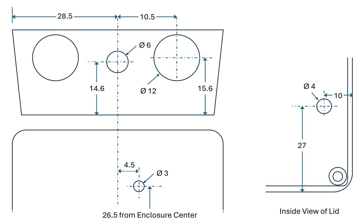

The circuit is easy to construct, but it’s a tight squeeze in the enclosure (Hammond 1591XXMGY), caused by the 4mm banana sockets. If you don’t need the sockets (for instance, if you intend to permanently wire a couple of test leads to the circuit) then everything will fit in the enclosure with plenty of space to spare. There’s an even smaller enclosure (Multicomp G404) that can be used in that case.
If you're using the Hammond enclosure, the drilling detail is here:

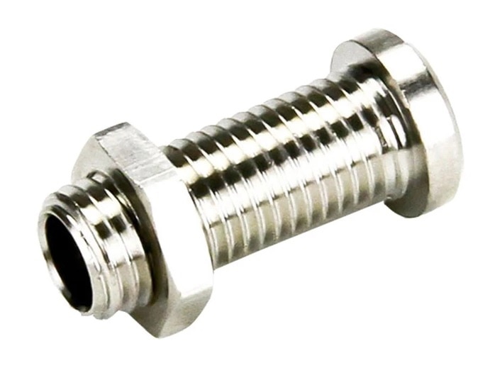

    shabaz over 1 year ago in reply to genebren
    Those look excellent to have around for some projects. The main issue is that most test probe leads have plastic shrouded banana plugs, which limits the choice of socket to the larger ones. However, I noticed that some test probe leads can come with simpler plain non-shrouded plugs (Probe Master sell them) but are more difficult to get hold of here.
    I saw some of these on the CPC/Farnell site, they would certainly speed up assembly massively, they are a bit pricier than hoped though. Probably these, plus a larger enclosure with removable end panels could be a nice option.
