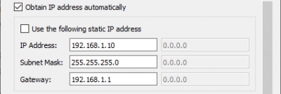

In order to use the ADP3450/ADP3250's Ethernet connection in Standard mode, make sure that the Enable Ethernet interface in the Standard Boot Mode box is checked.
If your device is directly connected to the host computer through an Ethernet cable, then you should set a static IP address on both the Analog Discovery Pro and on the network device of the host computer.
It should be noted that the DNS server settings are not applicable when using Standard mode. When connected to a router, the DNS server addresses should be obtained automatically.
Connection through a Local Network
If you are connected directly to a router or connected to a router through an Ethernet switch, then you should have the Analog Discovery Pro obtain its IP address automatically - so as to avoid conflicts with other IPs on the network.
With the Ethernet connection running, you can begin using the instruments as you would over USB.
You can follow the step-by-step guide on Digilent Reference Page to connect the Analog Discovery Pro to a network.

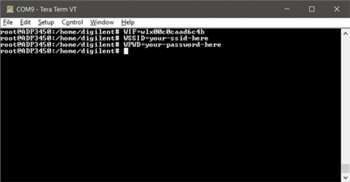

First of all, you need to switch to Linux mode. Connect a serial terminal to your device, which will be used later when logging into Linux mode. Find out which serial port the device is connected to and make note of it. Note that the serial connection should be established before booting into Linux mode, to ensure that no boot messages are missed.
Open a terminal emulator, such as TeraTerm, and connect to the noted serial port
Configure the network settings of the Analog Discovery Pro in WaveForms.  To most easily connect to the internet, you should be connected to an access point that provides DHCP, typically a router. Check each of the “obtain automatically” boxes in order to take advantage of this.
Log into Linux mode in the terminal. By default, the username and password are both “digilent”.
Now, you can choose to connect Analog Discovery Pro to the Internet by ethernet or Wi-Fi. For example, if you plan to use wireless network, a Wi-Fi dongle is plugged into one of the USB ports at the back of the device. In the terminal, run ip l to get a list of network interfaces. In this case, the WiFi interface is `wlx00c0caad6c4b`, the final network interface in the screenshot to the right. Create the WIF, WSSID, and WPWD environment variables. You can also run some commands to set up a permanent connection even after a system reboot.
You can find out step-by-step guide for connecting Analog Discovery Pro to the Internet on the Digilent Reference Page.
