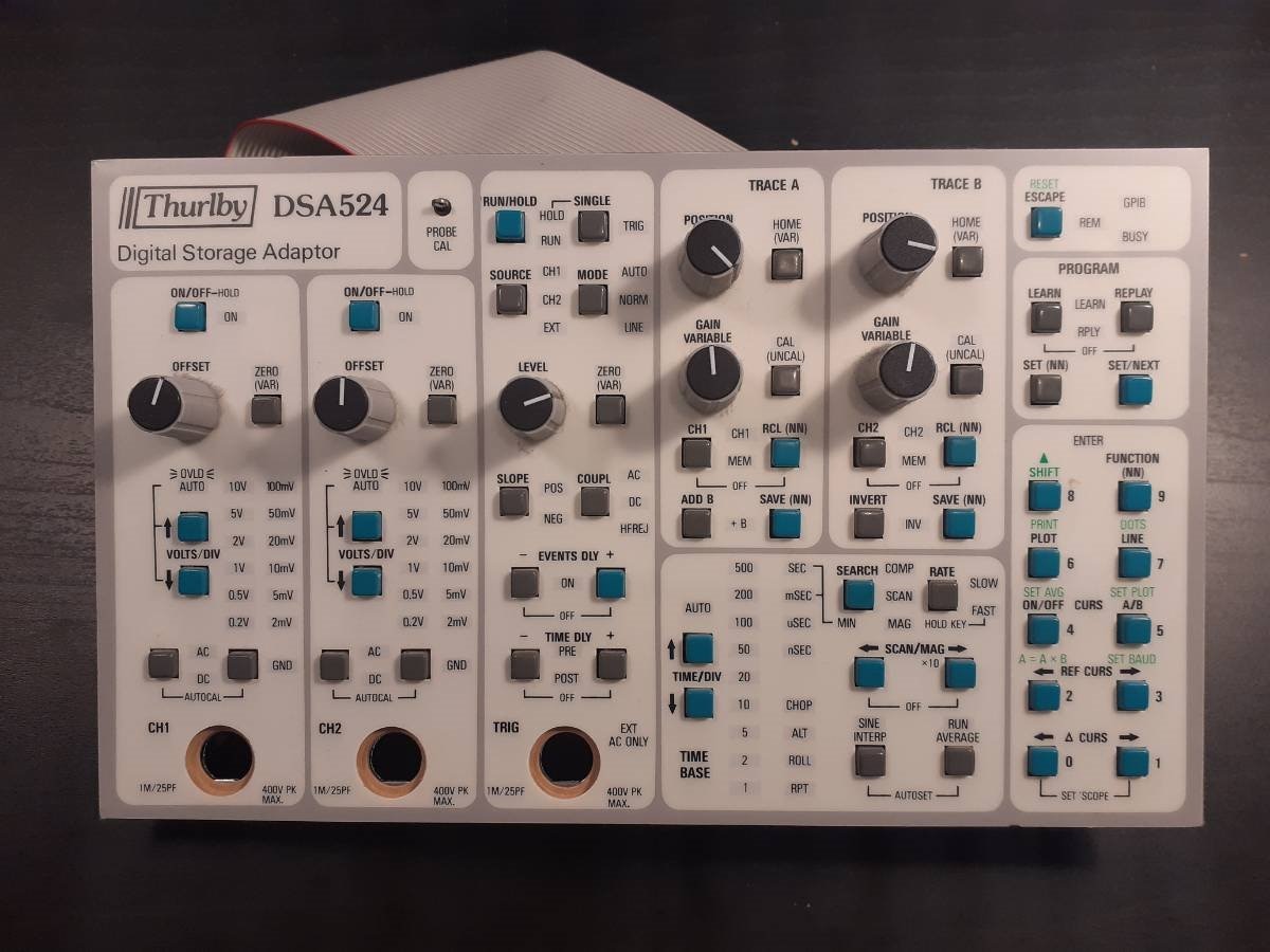

My curiosity got the better of me and I decided to take apart the Thurlby DSA524. This device is basically a Digital Storage Oscilloscope, without the oscilloscope part, that outputs an analog signal that let you use an old analog oscilloscope as a display. The captured waveforms can also be printed using an X-Y plotter or downloaded to a PC using the serial port or optional GPIB-port.
When looking at the boards it struck me that all the ICs inside seemed to be off-the-shelf components, most of which are logic gates along with a few OP-amps. Notably the analog section in particular make good use of the high input impedance and high voltage rating of 4000-series CMOS chips, while the digital section use 74-series gates for their higher speeds.
The circuits inside the device are an interesting combination of discrete transistor circuits along with integrated circuits, perhaps adapting proven designs or optimizing for cost? The date codes on the ICs seems to indicate that the unit was manufactured sometime in the second half of 1988.
The device is housed inside an off-the-shelf enclosure that’s been given custom-made aluminum panels. After removing the top the insides lifts straight up, with only a ground wire holding it to the shielded bottom plate.
To bring some order to this blog I divided it into sections, feel free to skip to the part of the teardown you’re most interested in.

The boards are neatly stacked and come out of the case in one piece along with the front and back panels. The front panels are both secured to the middle ground shield between the digital and analog sections. There’s a black ground strap hanging from the bottom that screws down into the shielding for the underside of the analog board. This wasn’t meant to be unscrewed, instead it’s one of three ground connections that has to be desoldered from the analog board when dissembling it.

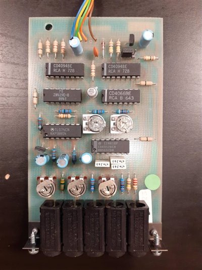

This expansion card is the first one in the stack of boards, and it’s used to drive an analog X-Y plotter to print waveforms.
The card outputs X, YA and YB analog signals along with a digital Pen Lift signal. The inputs to the card are +/- 5 Volt and ground, along with Clock and Data. The data line and clock signal load bits into two 4094 8-stage parallel output shift-registers that are daisy-chained in series.
The first 4094 shift-register is used to set the digital inputs of the ZN429E-8 8-bit R-2R DAC. The voltage reference for the DAC is a ZN404 2.45 Volt precision reference regulator (the metal can next to it).
The second 4094 controls the switches in a 4066 quad analog switch. This switch is used for the Y signal where it switches two different series resistor and trimpot circuits. One of these circuits pull the line to Vref and the another towards ground. I'm not sure if this is used to attenuate the signal or for level shifting.
The second 4094 is also used to control the addressing of a 4052 dual 1 to 4 analog demultiplexer. The Y signal input is buffered by an OP-amp before it goes into the first half of the demux. While the X signal goes directly into the second half of the demux. Each of the three analog signals X, YA and YB are buffered by the TL074CNTL074CN quad OP-amp.
The three white 47nF polymer capacitors (under the 4052 demultiplexer) are connected between ground and the positive input on of the three output buffer OP-amps. It’s possible that these are part of a sample & hold circuit together with the demux, which would be used to hold the output voltages steady while the others signals are changed.

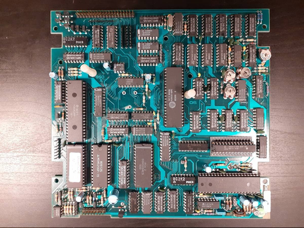

The digital section is laid out on a 4 layer PCB and its heart is a HD6303RP 8-bit microprocessor, which has peripherals and a bit of RAM built in. This microprocessor is object-code upward compatible with the classic 6800 line of microprocessors.
The 65C22 VIA chip in the middle of this board is responsible for reading and writing to the many shift registers found throughout this unit. It does so by clocking only one of seven shift register clock lines at the time, each going to a different part of the circuit.
The main ADC is the big 40-pin DIP in the bottom right corner, a UVC3120 8-bit flash type analog to digital converter that also has an R-2R type DAC built in.
Missing from this board is a big Ni-MH cell that was used to hold settings, waveforms and button press sequences in RAM when the unit is off. This cell was removed to prevent further damage to the board.

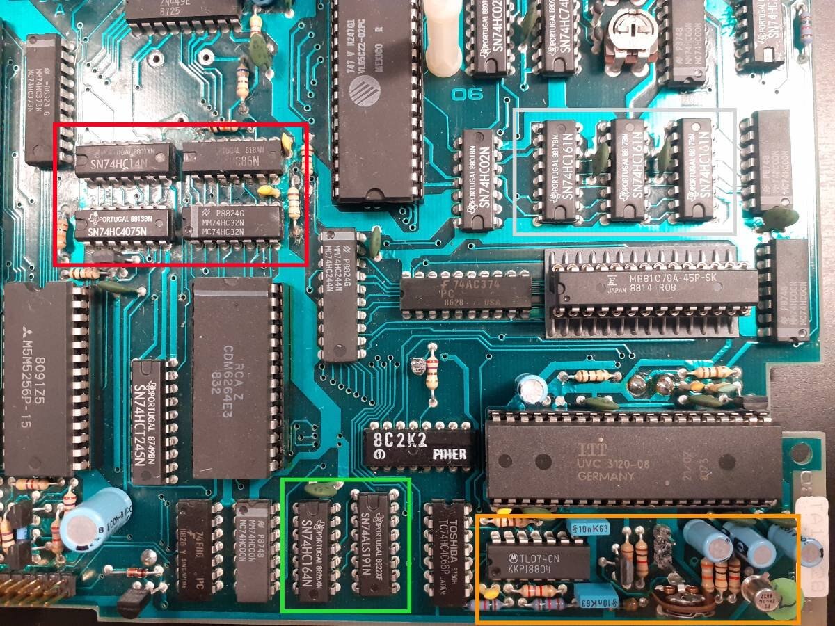

The microprocessor is not fast enough to do the sampling at 20 MS/s, instead it triggers counters and discrete logic that handles the acquisition. The acquired waveform is stored in a separate SRAM memory where the microprocessor can access it.
The 20 MHz timebase used for everything on the digital board is marked in yellow, along with its clock divider stages and clock frequency selectors. The 20 MHz clock comes from the oscillator made up of a 20 MHz crystal and a 74HC00 quad NAND gate. This 20 MHz clock is also divided down in stages by three 74HC390 dual decade ripple counters, so that the desired clock frequency can be selected using the 74HC153 dual 4-input multiplexer and 74HC151 8-bit multiplexer.
The ADC clock circuit is marked in brown. This clock is derived from the carry out signal of the 74HC40103 8-bit synchronous down counter, gated by a 74HC02 quad NOR gate and also fed into a 74HC74 dual D-type flip-flop.
RAM addressing, trigger delay and ADC voltage reference
The trigger delay circuit is marked in green. In this circuit the desired delay is loaded into the 74HC164 8-bit parallel output shift register, which loads it into the 74ALS191 synchronous 4-bit up/down binary counter. This counter is then clocked by the trigger circuit.
The ADC’s voltage reference circuit is marked in orange. This circuit get its reference voltage from the ZN404 2.45 Volt precision reference regulator, which is buffered by the TL074 quad OP-amp.

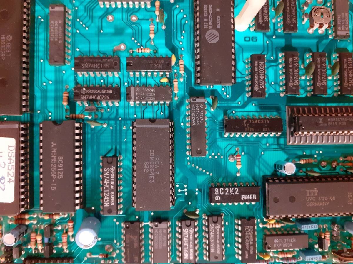

The RAM paging circuit that provides paging between the ROM and RAMs is marked in red (there are no less than three SRAMs in this device). Under it is the M5M5256P 32K x 8-bit SRAM used for the display memory. The paging circuit is made up of a 74HC14 hex inverter, 74HC86 quad XOR gate, 74HC4075 triple 3-input OR gate and 74HC32 quad OR gate. The purpose of this circuit is to page out the ROM and RAM from memory during ADC acquisition RAM write cycles, to make sure that the ADC timing isn’t messed up.
The three 74HC161 presettable synchronous 4-bit binary counters marked in grey make up the ADC acquisition RAM address counter. The clock the address counter come from the 74HC40103 8-bit counter that we saw previously in the ADC clock circuit.
The long narrow MB81C78A chip mounted in an adapter is the high speed 8K x 8-bit SRAM used as acquisition memory. The 74AC374 octal D-type flip-flop next to it isolates the ADC from the RAM, presumably when the microprocessor is reading from it.
Shift register clock routing and front panel control
The 74HC138 3-to-8 line decoder marked in purple is used to route the shift register clock signals generated by the 65C22 VIA around the device. This is effectively substituting for a missing chip select pin on the shift registers.
The three 74HC164 8-bit parallel output shift registers marked in blue are used to drive the front panel LEDs, using the two DS75492 MOS-to-LED hex drivers and the transistors in the top-left corner. The front panel is arranged in a matrix and the shift registers act like column and row drivers. The 74HC151 8-bit multiplexer marked in white is used to read the buttons on the front panel, while the button press scanning is done in software.
The 4051 8-channel analog demultiplexer marked in pink is used to expand the ZN449E 8-bit SAR ADC to eight inputs, enabling the microprocessor to read each of the seven front panel potentiometers individually.

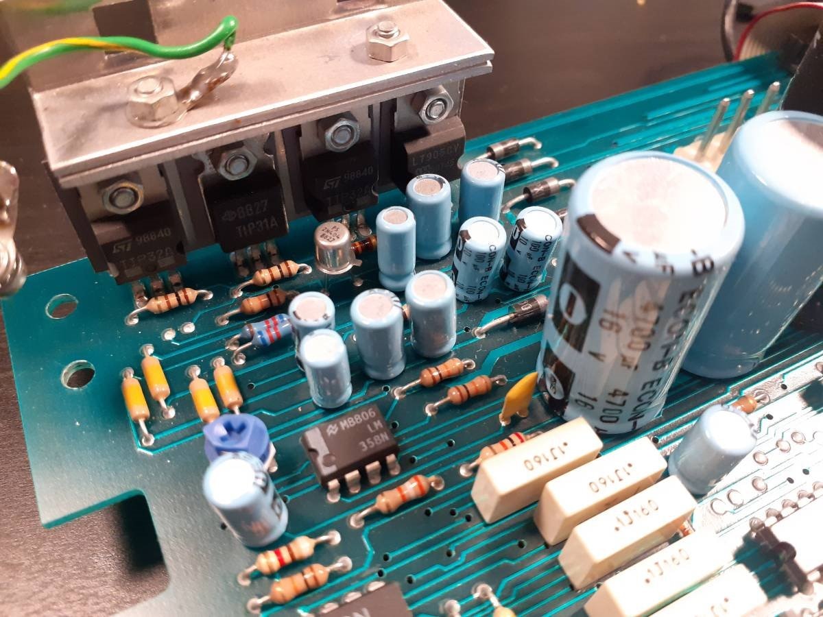

The power supply section provides four stabilized rails: +/- 7 Volt and +/- 5 Volt. The negative 5 Volt supply is generated using a regular 7905 regulator IC, while the other rails are generated using series regulators and OP-amps for the feedback loop (OP-amps controlling series pass transistor). The voltage references for all three series regulators comes from a ZN404 2.45 Volt precision reference regulator (the metal can next to the big transistors). The LM358 dual OP-amp in the picture is used for the +/- 7 Volt supply feedback loops and out of frame is a TL072 that's used for the positive 5 Volt supply.

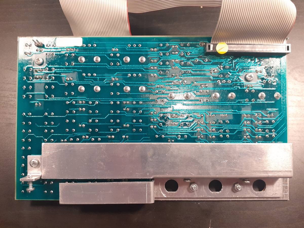

The front panel is just a passive board wired up in a matrix for the status LEDs and another for the buttons. The seven potentiometers on the front panel are connected to an 8 to 1 multiplexer that's feeding into an ADC.
