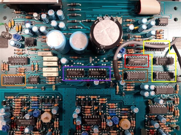

The analog section is laid out on a 2 layer PCB and contains the linear power supplies, the two oscilloscope input channels, the trigger input and two different sample & hold circuits.
The software running on the microprocessor does all the controlling of the input sections. In the middle of this board is the logic that’s used to send the control signals around the analog section.

Sample & hold circuit(s) and control voltages
The three 4094 8-stage parallel output shift-registers marked in yellow are used to control the attenuation for both channels and to select the trigger source. The 4052 analog demultiplexer marked in orange controls the final attenuation for the 5, 10 and 20 mV ranges of CH1, while the 4052 marked in brown controls the lower attenuation settings.
The big white 160 nF polymer capacitors are part of a sample & hold circuit that’s used to supply control voltages to the input stages. The two 4052 demultiplexers (marked in orange and brown) together with the 4051 demux (marked in red) are used to connect these capacitors to an input voltage coming from a DAC on the digital board. Two of the OP-amps in the TL074 (to the left of the white caps) are used for comparing the sampled and held DAC voltages with a reference voltage. The difference between the two is fed into the differential amplifier in the input stage that's used to correct for the DC-offset error.
Two 74HC4066 quad analog switches marked in purple make up another sample & hold circuit, together with the green topped 22nF ceramic capacitors just below them. This circuit is used for sampling the two channels, or either channel, before sending it onto the ADC on the digital board. This is how a two channel oscilloscope was constructed from a single input ADC. At this point the waveform signals are level shifted into the ADC's input range so the faster 74HC logic can be used.
