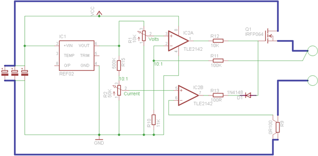

I will be putting together the video this week end to go with this schematic but I thought i would share this with you in the mean time
VCC can be as much as 40V (I was powering the test circuit on a breadboard with a bench PSU for now set to 30V, my psu max)
In the video I will be reviewing the behaviour of this circuit as well as Identifying a few pitfalls (Nothing serious and probably acceptable for a basic PSU but we do want to evaluate where we can improve on things
If you think you know the potential issues, please post and we will compare notes at the weekend image (There are two primary ones)

    Hello,
    I followed closely all your video materials about the modular bench power system
    (My question below might be of interest to your audience here)
    Can you suggest a principal circuit diagram for tracking control of symmetrical slave negative channel, using the same n-channel MOSFET?
    How would the negative part of the circuit would look like?
    I guess -- using again a differential amplifier for voltage control and curent limiter?
    Is it possible the negative part/channel to be controlled by the same potenciometers already present in the positive part/channel?

    Did you use the same above circuit diagram,  I posted.
    Do you have the correct voltage out of the VREF
    when you move the voltage adjust, does the input to the op-amp increase in proportion (Make sure the current pot is turned for MAX current, not minimal
    what is the output of the op-amp when you have max voltage selected,
    what it input + and - at  (Pin 2 and 3) ?
    I had fully tested this on he bench so I know the above diagram actually works but I suspect you may have a few deviations due to availability of parts etc. can you provide a schematic of what you built and perhaps a picture too to match it

    Hi i Built this up but it dose not seem toe work the only out put i get is 0.5 volts whet ever the pots are set to?
    i used an IRFP064N (just to check is the pin out G D S)
    also i used a FPR 4-T221 (it has 4 pins dose it matter which ones i used i connected first 2 to ground 3rd to op amp and 4 to output)
    i followed the diagram correctly i think.
    i would be very grate full for any help on this as its my first time building a bench power supply.

    What is important about the sense resistor is the ability to know its value and that it is stable
    a .1ohm 5W is perfect, you say it is a sense resistor, do you mean it is 4 terminal ? (Kelvin Connections)
