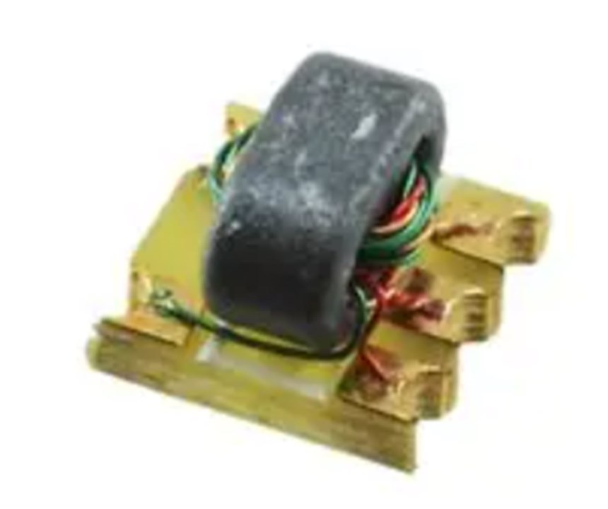

Here is another, far lower-cost, ready-made balun; the Pulse/Yageo CX2045LNL shown in the photo below is intended for 3 MHz to 300 MHz operation and has an impedance transformation ratio of 1:2.
image(Image source: Farnell website)
Note that not all baluns will be designed with the methods discussed in this blog post; the datasheets won’t mention that, since it’s irrelevant to the black box functionality of the balun. Some baluns might even be designed as normal transformers if they don’t need to be particularly wideband.

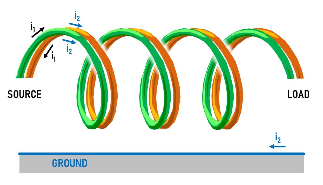

The diagram here shows what it's all about. If you had a single wound wire, it would have inductance that results from the magnetic field that the wire exhibits when current passes through it. That's a typical inductor, a single wound coil, that has an impedance that increases as applied AC voltage frequency rises, due to the changing magnetic flux causing a back EMF that reduces the changing current through the coil.
If you have two wires close together, with a source at one end and a load resistance at the other end, then the current that flows through the two wires is symmetrical, the magnetic field is canceled out, and the inductance is therefore greatly reduced. This is represented by the black arrows i1 in the diagram (although not shown, imagine a resistor has been soldered across the wires at the end labeled load); the current travels around the green wire, through the resistor, and then back up the orange wire.
However, if there is a common-mode signal on both wires, represented by i2, you could imagine that a return path could be, for instance, a ground connection (it doesn't have to be ground). Although not shown, that path to the ground could be through (say) stray high resistances, or perhaps capacitance between the wires and the chassis. Since the current is flowing through both wires in the same direction, this unsymmetric common-mode direction does not cancel out the magnetic field, and the two coils act like an inductor to the common-mode signal.
If the two coils were wound around a ferrite material, then the ferrite would absorb some of the energy from the common-mode signal, turning it into heat. The two coils and ferrite would become a common-mode choke, and it would work like this: Any signal i1 would pass through without (significant) loss because of the reduced inductance for differential mode signals as mentioned earlier. RF noise on the other hand (for instance an electromagnetic source, perhaps the switching noise from a DC-DC switching converter) would likely be picked up equally by both wires attached to the source and would be reduced by the choke since that’s a common-mode signal. All of this is a typical use-case for a common-mode choke.

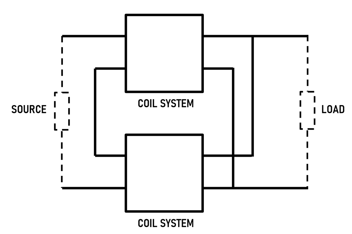

The diagram below shows an example of how two of the coil systems can be combined to serve a useful purpose. The topology is such that the left sides of the coil systems are wired in series, but the right sides are wired in parallel. If the transmission line impedance is 50 ohms, then the left side can be used to match a 100-ohm impedance with a 25-ohm impedance on the right side. The impedance transformation occurs with no loss since symmetric signals can pass through the coil system with no loss. This impedance transformation can theoretically occur for any frequency input signal since the analysis has already determined that for symmetric signals, there is little inductance; the whole system is wideband.
This transformation is extremely handy for matching antennas to radio transmitters or receivers that may need to be tuned across a wide range (if the radio is only intended for operating at a single frequency, then an LC circuit could be used to perform the matching instead; sometimes a tuneable LC circuit is used). Another important point with the Guanella component designed solution is that, as mentioned earlier, the AC isolation allows unbalanced output circuitry to be transformed into a balanced output.
You could combine additional coil systems to achieve different impedance transformations. For instance, if you had four coil systems all in series on the input side, and all in parallel on the output side, then that would be useful for conversion from 200 ohm to 12.5 ohm if the characteristic impedance of the transmission lines was 50 ohms. Incidentally, you can always work out the required characteristic impedance, by using this quick formula (it is the geometric mean formula, different from the arithmetic mean!):
Z0 = sqrt(Z1 * Z2) where Z1 and Z2 are the input and output impedances respectively.

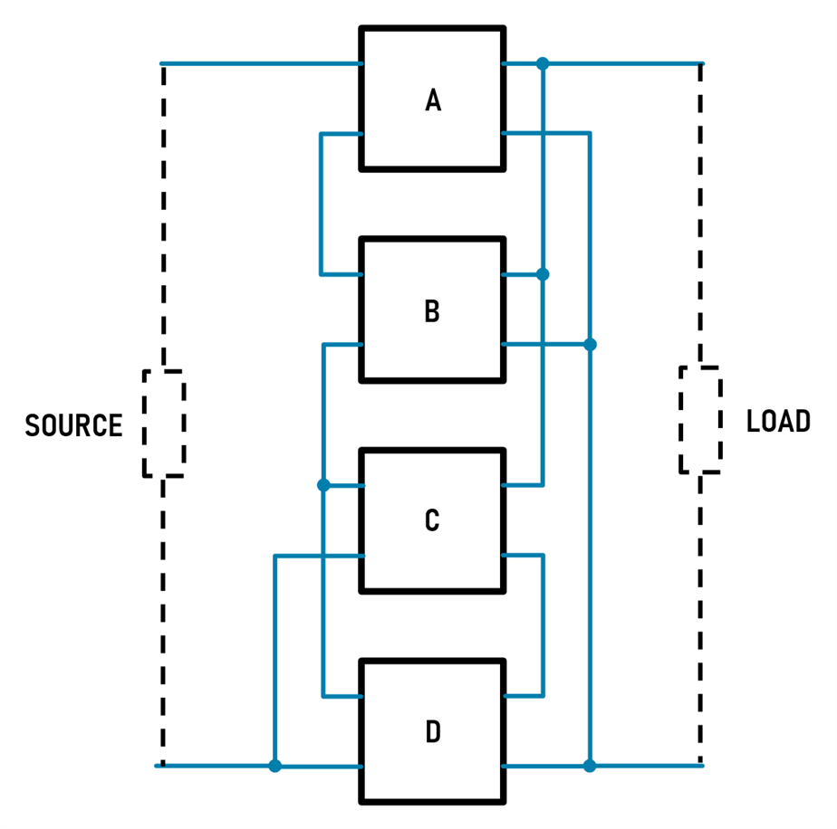

Generalizing this concept, you can see that by combining n coil systems in series on the left side, and in parallel on the right side, you can perform impedance transformations with ratios of n^2:1 with an impedance of n*Z0 on the left side, and (1/n)*Z0 on the right side, where Z0 can be in the approximate range of 30-120 ohms, for real-world wire and insulation dimensions.
In 1972, Donald McClure used Guanella coil systems to come up with a whole range of combinations that provide a variety of transformation ratios other than n+2:1.
His method relies on the observation that for useful configurations you could always connect the left sides in parallel or series, provided you connect the other sides in the opposite manner. Here's an example that provides an impedance transformation of 6.25:1 (i.e. 50 ohms to 8 ohms if the characteristic impedances of the pairs of wires is 20 ohm) and if you look at the coil systems labeled A and B, you can see they are wired in series on the left side but are wired in the opposite manner i.e. parallel, on the right side. Similarly, coil systems C and D are in parallel on the left side, and in series on the right side. Group AB is in series with group CD on the left side, but group AB is in parallel with group CD on the right side.
Donald McClure used his own unique notation to describe the configurations. For instance, the above configuration left side would be described as:
In the above notation 2S means that two coil systems are connected in series, 2P means two coil systems are connected in parallel, and the S means that the resultant subsystems from the previous step are connected in series. The right side can be described by replacing P with S and vice-versa.

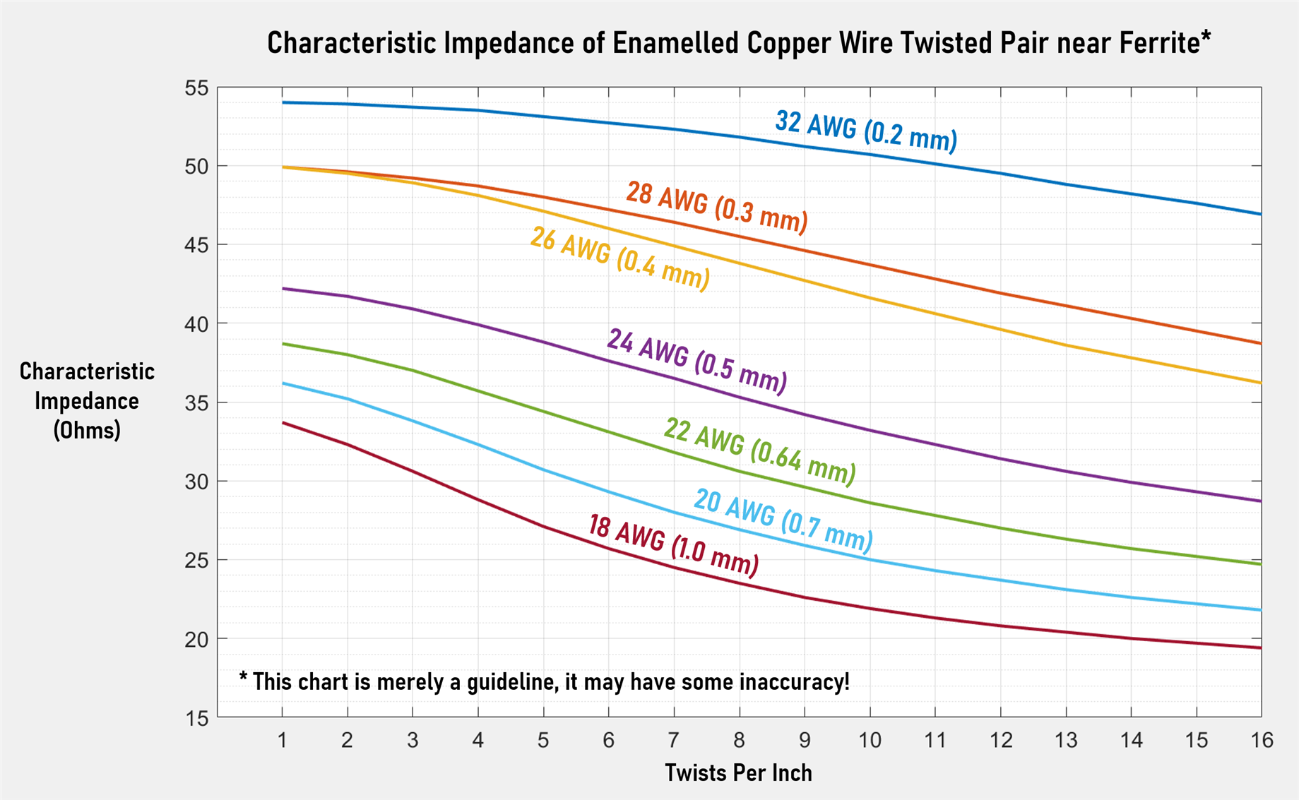

Coax is already conveniently available in 50-ohm and 75-ohm versions. For parallel or twisted pairs of wires, it is harder to calculate the characteristic impedance, however, some guidelines are suggested here (I’ll update or add to this list if people have better real-world experience and can provide advice in the comments):
For 100 ohm characteristic impedance, the easiest method would be to use ready-twisted-pair wire from Ethernet cables.
For 50 ohm, if you’re using enameled copper wire, here are the suggestions:
For 32 AWG (0.2 mm diameter) wire, you can twist the wire at about 10 twists per inch, or alternatively if you can place untwisted wires against each other side-by-side, then the impedance will be acceptable at just over 50 ohms. You can buy ready-paired wire glued together; it’s called bifilar wire.
For 28 AWG (0.3 mm), a few twists per inch (perhaps 3 twists per inch) is suggested; you could also use parallel untwisted wires (bifilar).
For 26 AWG (0.4 mm) wire: No more than 2 twists per inch; parallel (bifilar) wire is fine too.
For 24 AWG (0.5 mm), parallel wire is acceptable, providing a characteristic impedance of just under 50 ohms; if there are any twists, then the characteristic impedance will drop to 40 ohms if the twisting is about 2 twists per inch.

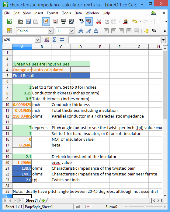

    Hi Jon,
    That's great to see the actual results! The 2-3 ohm increase near ferrite sounds good, it should only be about this amount. Similarly, having twisted pair turns near each other doesn't impact too much.
    However, I would have expected the characteristic impedance to be higher, with the thicker insulation, even if it is some other insulator. Is the wire thicker perhaps?

    The 38 SWG result sounds spot on. I calculate about 77 ohms with 2 turns per inch using my rough calculator (which I can't guarantee is error-free).
    I've attached the Excel file to the blog post, if you wish to experiment with it.

    The odd result with the wire-wrap wire was down to me not doing the probing very well. If the ground ring of the probe is very close to the ground side of the line, but doesn't touch, there's enough capacitance between them to still get a moderately sensible looking trace. I've tried again and now get this. This suggests something in the area of 140-150 Ohms.
    That's now in fairly close agreement with your spreadsheet calculator.
    What does the 'hard insulator'/'soft insulator' choice mean?

    shabaz over 4 years ago in reply to jc2048
    Hi Jon,
    That's awesome, the measurements are looking good!
    I've not seen a proper definition for hard versus soft insulator, so I've taken it to literally mean if the insulator feels soft (like PVC) or not, i.e. I always leave it set to hard for enamelled wire and Kynar/Teflon, which are usually the wires that might be used, for most twisted pairs.
