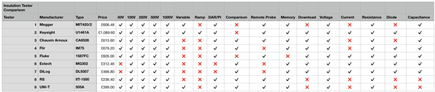

The UT505A is of similar size to the Keysight and Megger units, there are however, very few ergonomics to it in comparison to the other two units.
The UT505A is more in line with an insulation tester in terms of the functions offered. It does have voltage and resistance measurement to add to the insulation test capability, but lacks the multimeter functions that are now being seen on some of these instruments.
Interestingly, it does have a variable voltage function, that is lacking in a lot of insulation testers. This is not a ramping function though and has to be adjusted manually by the operator. Its official price  puts it in the mid range of insulation testers available, quite a bit higher than the Exotech and RS Pro units. I say 'official price' as I haven't actually seen anybody selling it for that, and it can usually be picked up for half price or even lower, making it actually the cheapest meter tested to date.
In terms of its insulation test functionality, the 500V test range, that I am predominantly interested in is limited to 500MOhm, similar to the Fluke, Flir and RS Pro units and drastically below the Keysight and Megger units that will reach up to 200GOhm. The UT505B model would go up to 100GOhm, so would have resolved this issue had it been available.
The resistance measurement function offers an automatic test current adjustment, that exceeds 200mA for earth bond testing, as required by the IEC standard.

I find the UT505A to be a bit of a mixed bag. In some respects, this is quite a good instrument. The build quality is good and is close to matching some of the higher end units. It has a nice large clear display, enhanced by the backlight. There are options to select different timed ratios to the standard, DAR and PI seen in the UK. It has the ability to adjust the test voltage, both before and during a test.
Some of the implementation however, leads to be desired. A lack of insulation values displayed during a PI test, leads this test function to be redundant. Recording insulation values during a PI test is fundamental to this style of test. The 500MOhm limitation on the 500V range, whilst being comparable to other insulation testers I have reviewed, just isn't adequate for testing modern insulation systems.
The operation of the lock function needs to be addressed. For me it should default to being off after changing ranges and certainly after switching the meter off and back on again. The meter also needs to switch the output off after a PI / DAR test. I am not sure if this is the way the meter operates, or if it has developed a fault during my time using it.
The quality of the test leads, let the unit down, and could interfere with the test results on a polarisation index test. It would be interesting to see if the UT505B, with the higher resistance capability, comes with the same leads. I also have doubts over the CAT IV rating, there does not appear to be any independent verification of this.
Whilst this has been an interesting unit to look at, given its functionality and accessories, I couldn't honestly say it would be a good purchase at its recommended price. At the discounted price, it can be obtained for, it becomes better value for money. But it only really has the ability to carry out basic insulation testing. The inability to download test results and limited insulation resistance values at 500V means it won't be going near any generator rotor I test. If you are looking for a basic tester though for general use, it could be a worthwhile contender.
