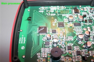

Build Quality
Uni-T is renowned with producing budget style instrumentation, so I was keen to take a closer look at the unit. The case is full moulded, with an outer red moulding, that gives the impression of a protective rubber coating. Whilst not quite as hard as the grey plastic, it does not provide the same protection as a separate rubber boot, such as those found on Keysight instruments. There are probe storage grippers on the back of the instrument, that do work well with the probes supplied, despite their chunky nature.
The tilt stand and battery cover are removed as one by undoing three machine screws. With the cover removed, these screws are all retained within the cover, preventing their loss. Quite a nice touch, from a more competitively priced instrument.
With the rear cover removed, another nice touch is seen. The battery case leads are held in place on the back cover to prevent strain on the soldered connections and a small JST style connector is used to connect the battery leads to the main PCB, allowing the back cover to be easily removed out of the way.
The meter is marked as having a CAT IV input rating to 600V. Whilst the input jacks are screwed into a full plastic moulding, giving great mechanical support, and there appear to be isolation slots around the positive input terminal, there are only two MOVs and two quite small PTCs to protect the voltage input.
Whilst the PCB is 'busy', its layout does seem quite neat. The pulse transformer for the high voltage is situated close to the insulation test output terminals and looks to be switched through an Omron relay. Two other selection relays, also Omron are located on the opposite side of the PCB of the resistance and continuity function.
The continuity function is protected by a small 20mm HBC fuse, but this will have a low breaking capacity and does not afford the same protection as the voltage inputs if an error is made. All four input jacks are held in place with machine screws. The two remote probe connections clip around stubs, pressed into the plastic case.
The main microcontroller is from Silicon Labs, a C8051F340, 8 bit 50Mhz device, and a PCF85176H display driver form the brain boxes of the UT505A.
The main PCB is held in place with 4 self tapping screws into the front case. Inspection of the PCB shows good attention to detail. There were no signs of modifications to the PCB or residue around any of the solder joints. A little bit of mastic type substance was found providing support to a bridge rectifier component.
The front side of the PCB contains the main selector switch, function button pads and the display.
A small pice of plastic debris was found underneath the selector switch, other than this, no debris was found inside the case.
Overall, this is a reasonable quality unit that Uni-T have produced, with some very nice touches to it, that are not found in other more expensive insulation testers.
