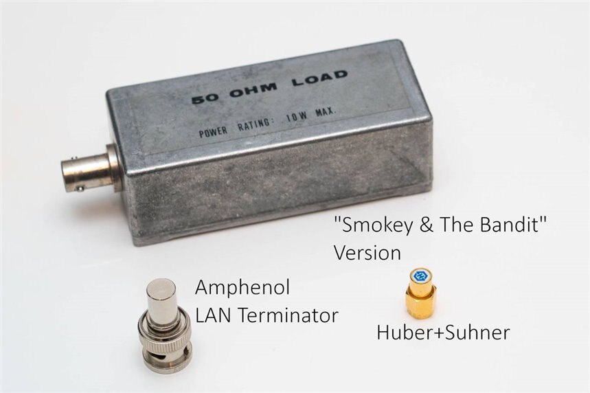

Huber and Suhner 50 ohm SMA Terminator

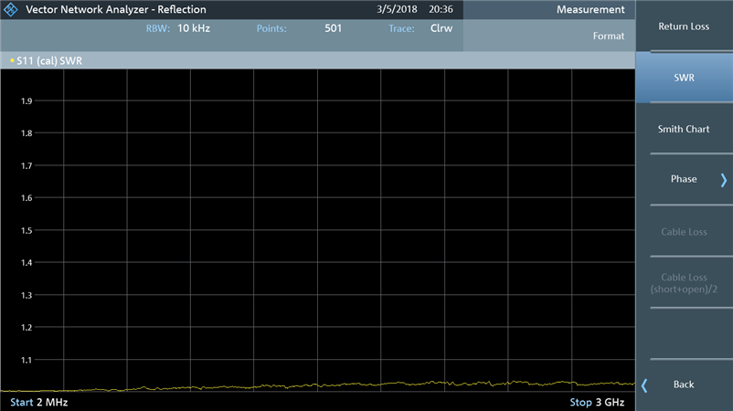

First off I examined the high quality load, which is a Huber and Suhner 50 ohm terminatorHuber and Suhner 50 ohm terminator. I tested between 2MHz and 3GHz. For this entire range, it looks like a single dot in the center of the display.
It is hard to see it, but it is right there in the center – at the position which represents 50 ohms (the position is marked 1 but the scale is 1:50).
The VSWR chart also shows what a good 50 ohm termination it really is – it is a nearly flat line of 1.0:1 VSWR for this entire frequency range. Toward the upper frequency range it reaches around 1.03:1 VSWR which is still tiny, and some of that will be due to cables and connectors.
Amphenol BNC Terminator
Next, I tried the Amphenol BNC terminatorAmphenol BNC terminator which costs a lot less. As can be seen, at higher frequencies it does not behave like a pure 50 ohm load. This is to be expected; it is a lower-cost terminator that is intended for coaxial cable based voice and data networks, and only needs to function well at up to a few hundred megahertz.
The VSWR chart also shows this to be the case; the marker is at 1GHz where it is already up to a VSWR value of 1.3:1 which is not great, and beyond 1.5GHz it really is extremely unusable. But as mentioned it was never intended for these frequencies.
Homemade 50 ohm Load
I also examined a homemade 50 ohm load. My excuse is that I built this as a teenager : ) In any case, high frequency for me at that time was 27MHz, and that was what I created this load for, for playing around with citizens’ band (CB) radio.
You can see internally it just consists of twenty 1k ohm resistors, all in parallel, to provide 50 ohms. The center junction forms one end of the parallel resistors and it is connected to the coax center wire. The outer ends form the other side of the parallel resistors, and are connected to the coax shield and the enclosure with the screws and solder tags.
The marker is set at 100MHz; beyond a few tens of MHz, it is completely useless as a 50 ohm load : ) In fact at some frequencies (near the left side of the Smith chart) it looks like a near short circuit, and at others (near the right side of the chart) it looks like a very high resistance : )
Huber and Suhner 15W Load
And finally I took a look at an off-the-shelf load which would have cost around $200 when new. Again, ebay should be avoided for cheap ones.. they may have some branding on them but that could be fake, and you wouldn't know for sure without testing it, and could damage the attached equipment if there is a mismatch, i.e. causing power to be not absorbed. This particular Huber and Suhner 15W load is pretty old but genuine.
Unfortunately I have a chain of RF adapters attached to it, and some are very old. If I replaced them, I’d get better results. But I would not have known that for sure without applying it to the VNA. I had to unscrew and tighten several times to get it ‘just right’. I will purchase new adapters now, as a result of seeing the results on the VNA. The Smith chart shows the slight mismatch across the frequency range.
The VSWR was under 1.2:1, across the entire 3GHz span which is quite good, but I know this load is capable of better results without that old chain of connectors.
Summary
When it comes to 50 ohm loads and terminations, I think it is definitely worth investing in decent ones especially if you’re planning on using it at frequencies higher than a few hundred megahertz. The small Huber and Suhner 50 ohm terminatorHuber and Suhner 50 ohm terminator is under $20, which is really good value, confirmed from the results from the FPC1500 in VNA mode.
