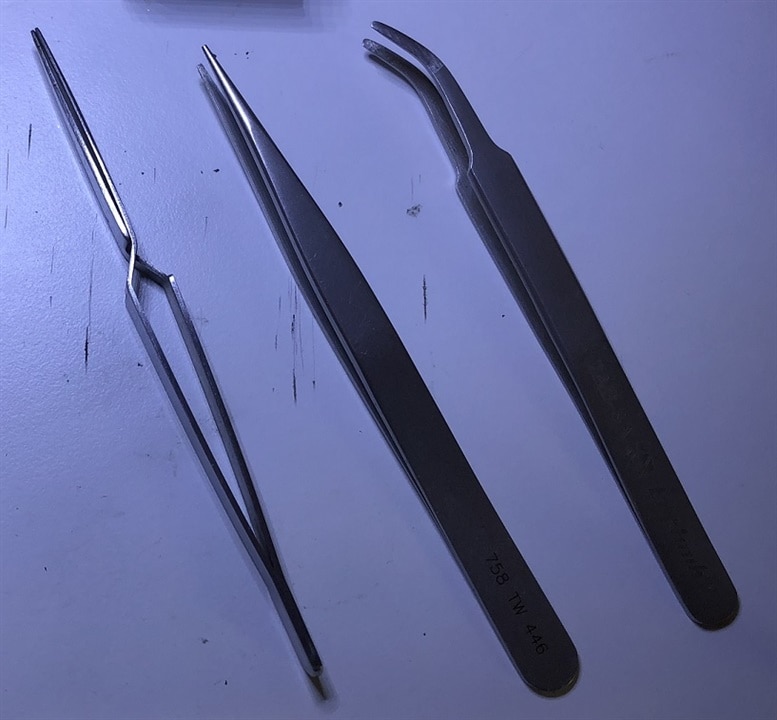

    This is my go to set of tweezers (although one of them is currently missing - hopefully to be found when I get around to cleaning my workspace).
    The first one is a simple self-closing, pointed tweezers that I use to hold parts to the PCB while tacking a few leads down.  This pair is a super cheap unmarked that I picked up somewhere many years ago.
    The second one (currently missing) is a heavy duty (nice and thick), pointed tip tweezers (marked 758 TW 446).  This is a somewhat pricey piece that I have owned for quite some time.  Again, I have no idea where I picked these up, but they are Swiss made and list for around $25-30.  These have such a nice hand feel and I hope to either find them (in the mess) or replace them sometime soon.
    The third one is my current favorite, a curved, round tip pair, 2AB-SA from technik.  I have found the curved, round tip tweezer to do a little bit better of a job in picking up small (0603 and 0402) parts.  I like that the curved tips offer a much more comfortable hand position, often allowing me to rest my hand on the board holder, thus reducing fatigue while soldering for several hours.
