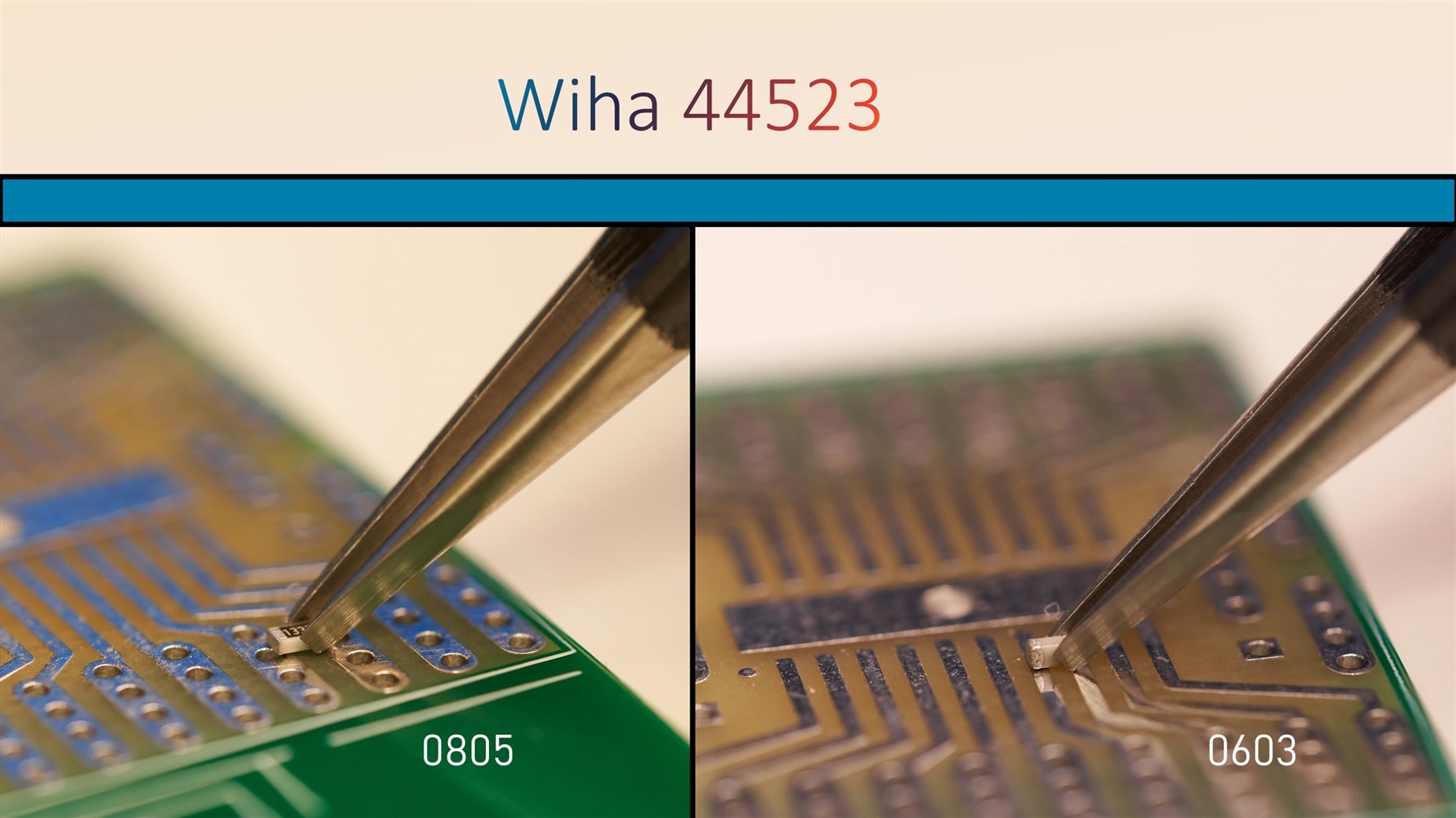

I tried Wiha models 32325 and 44523 . The former is a little cheaper than the latter, but the 44523 feels better in the hand. Perhaps there is a slightly better surface finish too. To me, the 44523 feels identical, or near-identical to the VOMM ones that I lost, but the 32325 feels pretty great too.
Incidentally, all the documentation on the Internet for the two tweezer models is incorrect; the tweezer datasheets/catalog pages have got the lengths wrong. The lengths in my photo above are correct.
With both of them, I didn’t lose any components during experimentation. They grip the parts reliably, and the tip is a comfortable size and shape for working with typical SMD parts.
The photo below shows the 44523 gripping an 0805-sized resistor and an 0603-sized capacitor.
