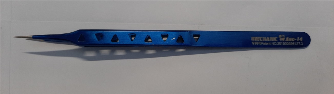

    I'm using these non-branded set of tweezers that I bought on Amazon. A few tweezers are somewhere on my workbench...
    I recently bought the mechanic tweezers from Banggood after watching the NorthridgeFix videos. These tweezers have good, pointed tips and the tweezers are quite sturdy.
