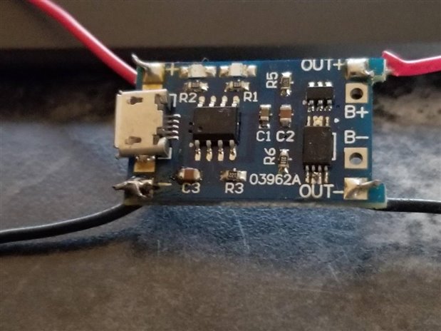

    Sorry, my scope is a Siglent SDS1102CML+ 100Mhz model . I know there's better but didn't go that route as I only use it as a hobby to keep me busy. In the good ole' days I was always throwing together radios, counters,  from parts my dad brought home from work along with other numerous things. I haven't built anything since other than computers Which I now at 63 use for my job..
    I have the basic understanding and am well versed using a multimeter. I've calibrated the probe and set it at 10k. I recently watched a video from a guy  using an Arduino to show basic measurement with the scope
    What intrigued me though was a video using a tp4056 to charge a Li-ion battery which I do weekly as I've become my neighborhoods "solar light repairer."  In the video he had his scope measuring the batteries charge And current draw. However he was using the older TP4056 and I haven't yet to identify the same point on the new version with battery thermal and overcharge protection.
    From the tp4056 data sheet it should be the PROG(Pin 2): Constant Charge Current Setting and Charge Current Monitor Pin which I've yet to find.

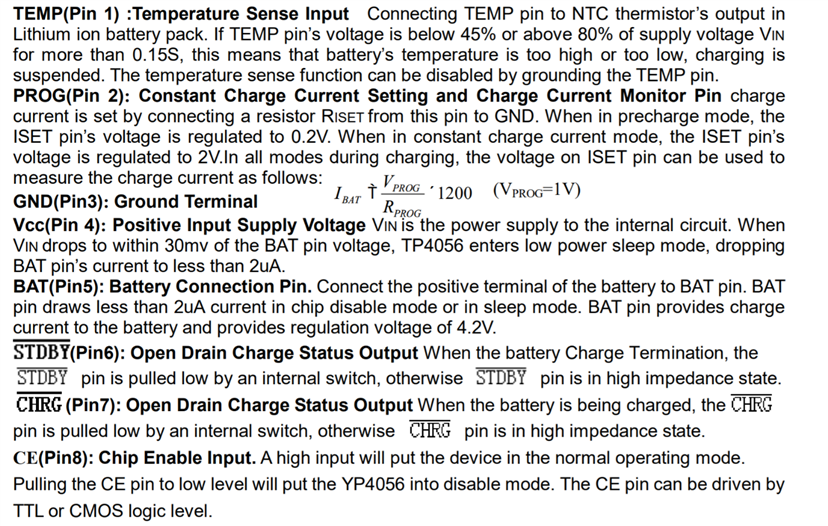

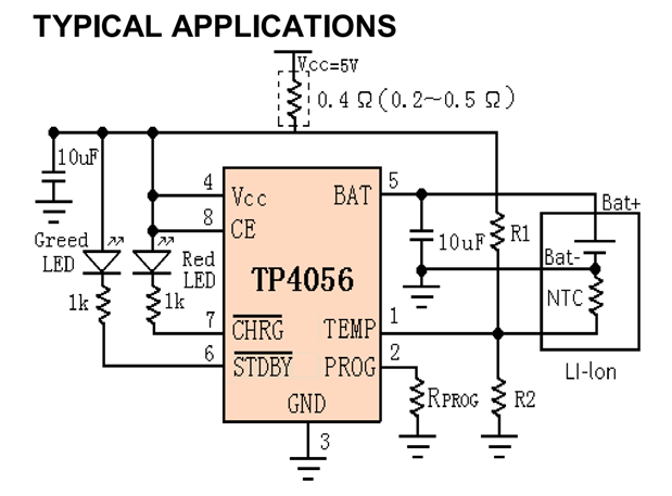

    shabaz over 6 years ago in reply to cyberwasp
    The explanation in the TP4056 PDF datasheet was a little hard to follow, but it does appear you could measure the voltage at pin 2 to determine if it is in pre-charge or not. However, it would be easier to determine that using a multimeter set to amps, in series with the power source. If the current is high then the battery is not in precharge state.
    To determine if the battery is charged or is in a charging state, then pins 6 and 7 can be examined, according to the text below, extracted from the datasheet. None of this needs a 'scope (although if you have it it is a good opportunity to use it), a multimeter could be used (and if desired LEDs attached to pins 6 and 7 as shown in the circuit further below). If you mean to use the scope to plot a chart over time of the battery terminal voltage, or current, or something else, then normally an oscilloscope is not used, because it is such a slow-changing thing (the charging may take at least an hour normally. Some multimeters will log data, or some code could be written to capture this from a 'scope, or something like 'Analog Discovery' could be used. It would be an unusual thing to measure though, because for a repair all you'll usually care about is if indeed the battery is charging or not, if it does reach the termination state, and how long the charged battery operates the product. I may have misunderstood your requirement.
