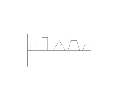

  • edmund
    edmund over 16 years ago in reply to Technocrat
    Dear All,
    my 2 cents thoughts
    We can breakdown into 3 simple parts
    diverse => Different kinds, behavior
    successive => repeatitive
    pulse shaped DC current => As the name per says
    Below is an example (correct me if I am wrong) . I guess customer might be using this kind of pulses for some form of electrotherapy experiment.
