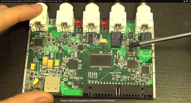

    shabaz over 11 years ago in reply to shabaz
    Just noticed someone did a review and teardown of an Analog Arts 'scope. I've not watched it (got other things to do ; ) but a quick scan of the comments was interesting.
    https://www.youtube.com/watch?v=F-1uA4Iwce8

    waelect over 11 years ago in reply to shabaz
    Long video but also comes with caveats, in a general sense it was a thumbs sideways for the product as he received a serviced unit, not a new one. On the video it doesn't instil confidence in the product.
    I am not sure I would have reviewed it at all until I received a new unit.
    Initially I oooo, and ahhhh the specs but as the video progress I became a bit disappointed with the product. Without a response from the manufacturer I would not buy the AA USB scope.

    Robert Peter Oakes over 11 years ago in reply to waelect
    Ya, the claims significantly outweighs the actual abilities, but as stated on the video, if you stick within its real bandwidth (Below the nyquist frequency limits of the ADC, DAC etc then it seems to be quite capable. Pay attention to the cross talk across channels he demonstrated too, not a good thing.
    He also pointed out that his Surface Pro 3 could not power the unit so if you plan to use it with laptop or tablet, there might be an issue
