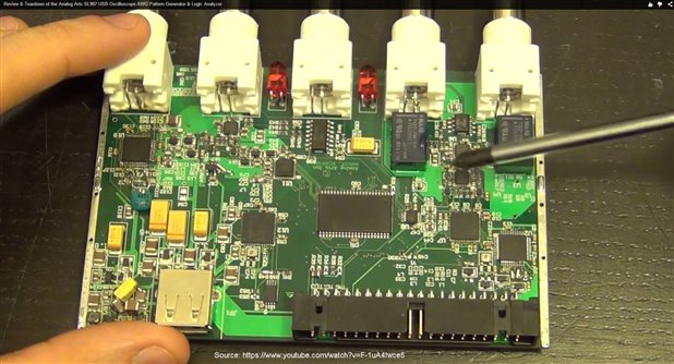

    shabaz over 11 years ago in reply to shabaz
    Just noticed someone did a review and teardown of an Analog Arts 'scope. I've not watched it (got other things to do ; ) but a quick scan of the comments was interesting.
    https://www.youtube.com/watch?v=F-1uA4Iwce8
