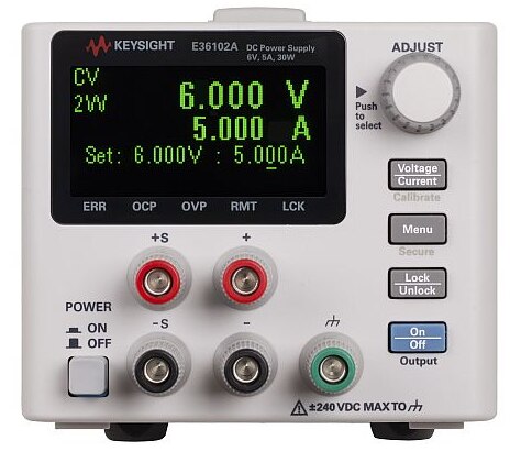

    0 Robert Peter Oakes over 10 years ago in reply to Jan Cumps
    Please be careful with the assumption that GREEN is the Middle because it is not, it is ground and only ground, it is possible that 0V may be tied to GND but should not be as assumption and with alot of electronics it is undesirable , in all of the above pictures Green is GND and not 0V, the one with Black as Ground goes against ALL convention and should be regarded as wrong or atleast very missleading
    In the PSU picture it clearly shows that 0V can go as high as 240V above GND but no more, there will be MOVs etc to prevent it from happening but outside of that, the - and + are isolated from GND

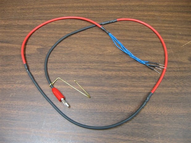

    0 jw0752 over 10 years ago
    Since there doesn't seem to be a hard convention for the center ground wire from a dual voltage power supply I have devised a potential candidate for your approval. My choice of colors represent that it can be either the positive or negative lead depending on the side of the power supply it is relative to. Also I have made the bread board tails blue to eliminate confusion that it is anything but the 0 reference on the bread board. Thanks for responding so quickly to my question.
