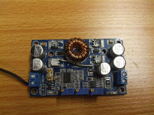

I am building my own (2 channel) lab bench. This is the conversion board I'm using to convert 12V (input) to 1-24V (one for each channel).
In the product description they say
Input reverse connect protection: No (If necessary, please input series schottky diode)
Output control flow backward: No (If used for battery charging or load is bring electricity load, please on the output side series schottky diode)
This does mean that there is no reverse polarity input protection (that is not needed anyways), but does this mean that there is reverse polarity output protection?

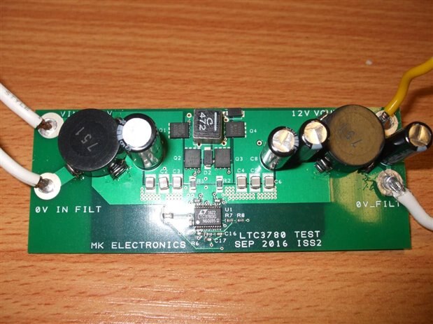

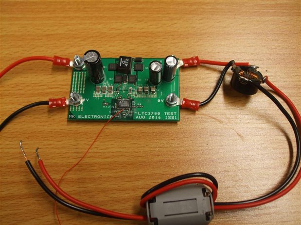

    Hello Tim,
    The noise is un-fixable by any reasonable means - it consists of bursts of very large amplitude 50-130 MHz decaying sine bursts as the power devices switch. We put at least 160 hours of engineering time, two pcb iterations  and 2 test board designs into this. We added every possible external filter and tried countless different capacitor and inductor filter combinations. We had a 1GHz scope and a spectrum analyzer to help as well. We just could not get the power devices to switch cleanly.
    The pictures are our test board, issue 1 and 2 (note the increase in filtering) and the cheap board from Amazon (which we tweaked to no avail). I don't have a picture of the official demo board. The best one is our own with the extra filters (450mV p-p at about 75 MHz) but the the high frequency noise couples into pcb ground planes and finds its way round filters. The LT demo board gave about 800mV p-p at 90MHz. In both cases the noise takes the form of short (a few cycles) bursts of rapidly decaying HF sine waves.
    In the end we took the 'easy' option and completely re-designed the whole power supply image
    MK
    • Reject Answer

  • michaelkellett
    0 michaelkellett over 9 years ago in reply to tim687
    Tim Koers wrote:
    This is a similar board that I ordered. (see link in the first post). It's not just the LTC3780. Does this one have noise issues too?
    Oh yes - every board I've seen with this chip has noise issues - the different layouts and switching devices alter the ringing frequencies a bit but the output noise is huge - the Chinese board from Amazon was the worst (and had other issues as well) but all 6 boards I've seen (including LT's own) were dreadful.
    MK
