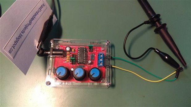

Hello All,
I've been working to learn more about analog circuitry, for this purpose I decided I would try a XR2206 bases function generator cheap yes, but hopefully a place to start. When I first received the unit I tested it (can't give a positive rating on eBay unless it works) and I was able to see the three waveforms. They had soem jitter and other issues but overall it worked.
Today I decided to get start really working with it and noticed that the XR2206 IC started to get very warm. As I was not 100% I had connected it the right way, I tried connecting it in reverse (probably not the smartest idea thinking back). The IC was still getting pretty warm and this was not even with the voltage at the recommended level (using 5V instead of 9V, I always start from zero and turn up the supply). I then disconnected the GND from the oscilloscope and the IC started to cool off, connecting it again and it heats up. I have now tried this with two scopes (TBS 120B-EDU and DS)X1120G) and the same thing happens with both of them. I do know that the plug all my equipment is connected to is not grounded (old wiring, looking to rectify this just not sure how at the moment).
If anyone has some ideas as to why connecting the scope would cause the IC to heat up I would be very interested in then and exploring this issue further.

    If it's drawing 220mA then the chip will get hot (3W at 14V makes for a very hot chip) . Almost certainly the chip is blown. It's a very long time since I used one of these and I can't remember how easy…

    Out of interest, what current is the circuit drawing with the load (O'Scope) connected and not connected? I may be wide of the mark here but the XR2206P has a minimum supply of 10V (Max 26V) - and a typical…

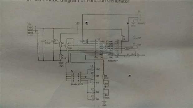

    If you show us the schematic and exactly where the scope is connected it might be possible to explain the heating up.
    A picture might help as well.

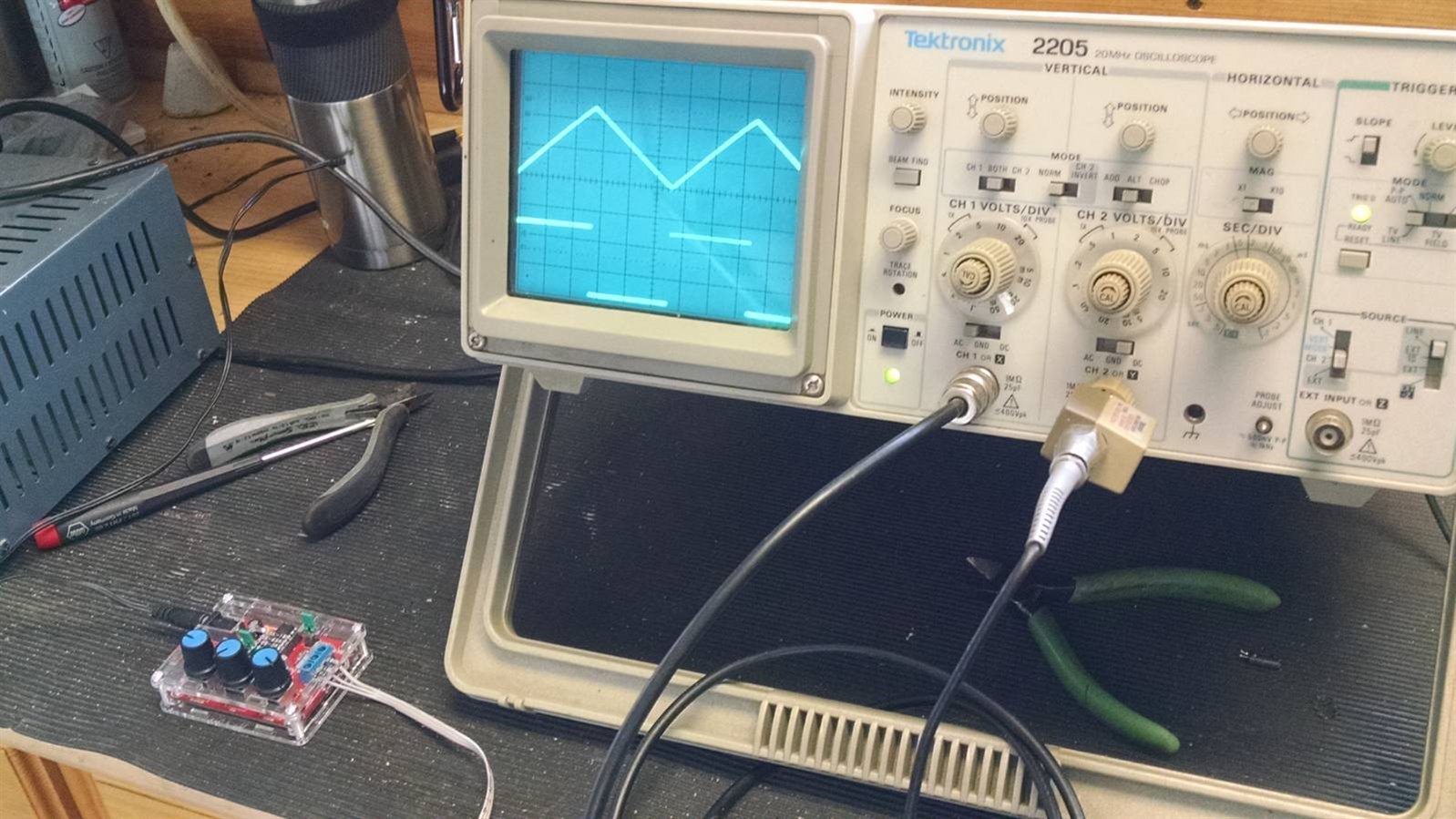

    I don't have a good picture of the schematic but I have included one that I have. I should mention as previously mentioned it appears the scope is not having an effect, I just thought it was at the beginning. Doing a second test has shown the IC heating up even with no scope connected. image
    This is the setup, cart is there just to ensure the two power points don't touch each other.
    Here is the schematic, sorry for the really bad quality.

    jw0752  apparently the scope and PSU are not currently grounded - the plug they connect to does not have a ground (old wiring according to kas.lewis
    220mA is WAAAAAYYYYY too high @ 14V!  (Absolute maximum rating IIRC is 750mW - 26V @ 20mA is only 520mW - You're ripping 3W plus through that!
    Does it still produce the waveforms out?
    I suspect you may have a goosed IC . . . .

    0 kas.lewis over 9 years ago in reply to the-dubster
    No waveform, it looks as useful as the sand it was made from...
