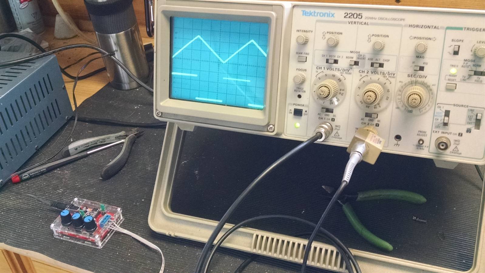

Hello All,
I've been working to learn more about analog circuitry, for this purpose I decided I would try a XR2206 bases function generator cheap yes, but hopefully a place to start. When I first received the unit I tested it (can't give a positive rating on eBay unless it works) and I was able to see the three waveforms. They had soem jitter and other issues but overall it worked.
Today I decided to get start really working with it and noticed that the XR2206 IC started to get very warm. As I was not 100% I had connected it the right way, I tried connecting it in reverse (probably not the smartest idea thinking back). The IC was still getting pretty warm and this was not even with the voltage at the recommended level (using 5V instead of 9V, I always start from zero and turn up the supply). I then disconnected the GND from the oscilloscope and the IC started to cool off, connecting it again and it heats up. I have now tried this with two scopes (TBS 120B-EDU and DS)X1120G) and the same thing happens with both of them. I do know that the plug all my equipment is connected to is not grounded (old wiring, looking to rectify this just not sure how at the moment).
If anyone has some ideas as to why connecting the scope would cause the IC to heat up I would be very interested in then and exploring this issue further.

    If it's drawing 220mA then the chip will get hot (3W at 14V makes for a very hot chip) . Almost certainly the chip is blown. It's a very long time since I used one of these and I can't remember how easy…

    Out of interest, what current is the circuit drawing with the load (O'Scope) connected and not connected? I may be wide of the mark here but the XR2206P has a minimum supply of 10V (Max 26V) - and a typical…

    I purchased one of these as a project for my grandson because it was inexpensive. And you get what you pay for but still well worth the money.
    I cant speak to you specific issue but .................
    To begin with there are a few design errors that will cause minor pain but nothing major such as R1 s/b 10k. R2 is wired backwards (clockwise decreases amplitude).
    R7 and R* s/b 10:1.
    Amplitude pot is linear taper and should be logarithmic,
    And other omissions in the design and incorrect values.
    But what was found was that the XR2206 ic included in the kit is not an authentic Exar part. (logo marked on part and it has fake datecode.
    It does not operate over the VCC specified range with stable output freq. and other issues.
    if you purchase an authentic part you will see a big difference.
    Here is a long boring video that describes some problems with the design.
    https://www.youtube.com/watch?v=02XtneCHnDA
    Keep in mind, all indications are the Exar (now maxlinear) XR2206 is obsolete.

    0 ewinter2112 over 9 years ago in reply to ewinter2112
    n was able to build this Friday night and Saturday morning.
    and it works fine for what it costs (7$). It has the known design issues some of which I helped him fix.
    There is a DC offset on the sine/triangle output which was be easily fixed. the addition of a trimmer pot for symmetry (pins 15 and 16) and a distortion adjustment on pin 14.
    Haven't connected any loads except a small speaker and the oscope.
    I would recommend reviewing other design schematics and the Exar specification for the XR2206 for insights on design errors and improvements to this inexpensive design.
    Still well worth the 7$.

    Grounding on some circuits can be tricky.  With parasitic inductance and capacitance, you may have a high frequency oscillation that your 20 MHz scope may not be able to show.  Try connecting the scope ground to the same point as the power supply ground.
