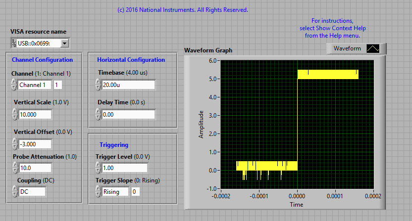

I'm trying to start a LABview project to control a TEK TBS2000 scope.
I've done this before for a RIGOL DS1052e - this is a scope that presents itself as a COM port with known BAUD rate, ...
The TBS2000 shows as a test instrument, and I can select it in LABvie as a VI device.
However, I don't succeed in sending and receiving data. I tried a simple *IDN? and comms fail (generic error: machine doesn't understand command or communication error)..
I've downloaded NI's example for TBS1000-2000 family and they give the same errors.
Anyone with an example?

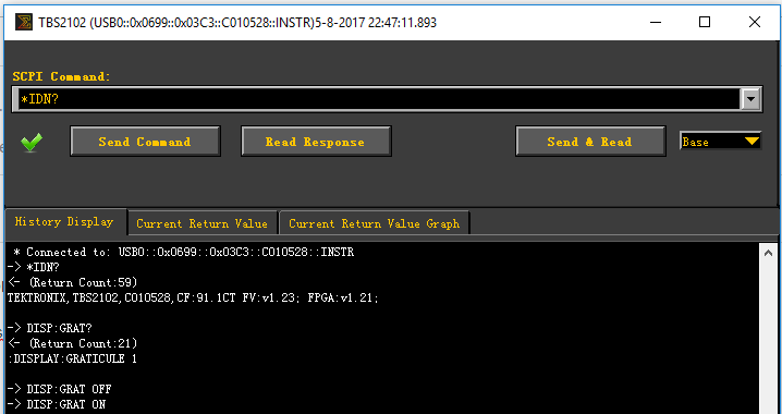

I know the TBS2000 works, because when I use the RIGOL SCPI command tool, I can select it and it replies to *IDN?

    Answering @self: I had to install TekVisa 404. I had an installation of OpenChoice-TekVisa 4.1.x and it seems that this one doesn't work with LABview 2014 (rant: LABview dependencies Are A NightMare )
