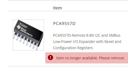

    ... except whe I'm trying to order. Doh.
    Looking for a replacement . Hang on ...
    0 Jan Cumps over 9 years ago in reply to Jan Cumps
    I re-checked and it's still an active part with no end-of life warning.
    PCA9557DR (essentially same part in different reels) is orderable

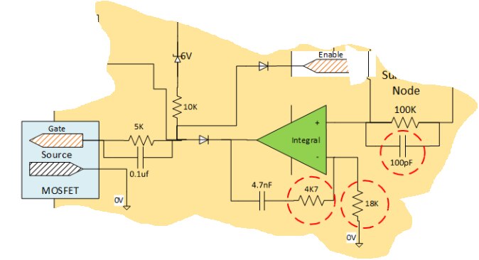

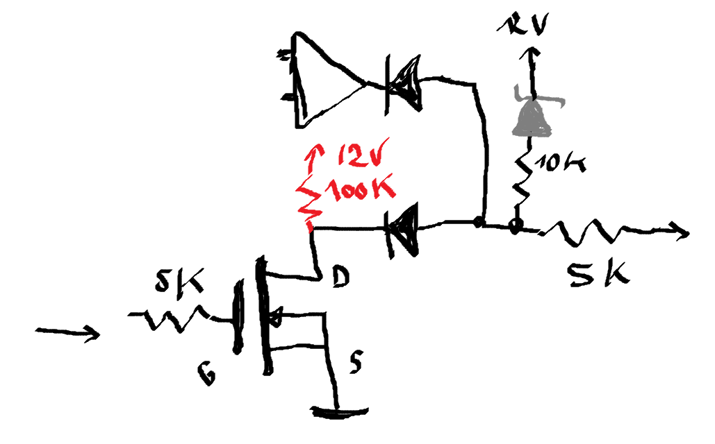

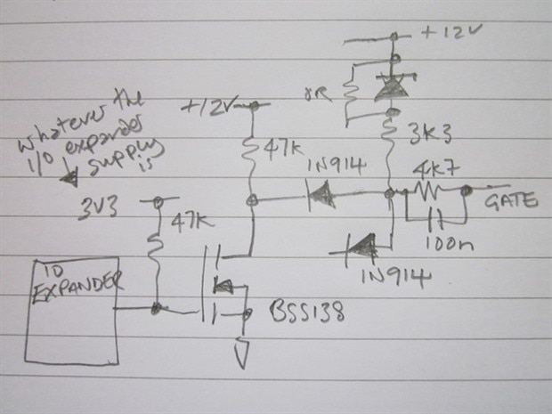

    Erm, what's this for exactly? If you're pulling down the gate of the output MOSFET, it needs to tolerate more than 5V. The nice power MOSFETs that Peter found and wants to use are not logic-level devices and the gate will be working up at 6 or 7V.
    A small MOSFET controlled by one of the regular outputs of your expander would be better.

    to provide the ~enable signal. Pull the node to 0V to switch off the load.
