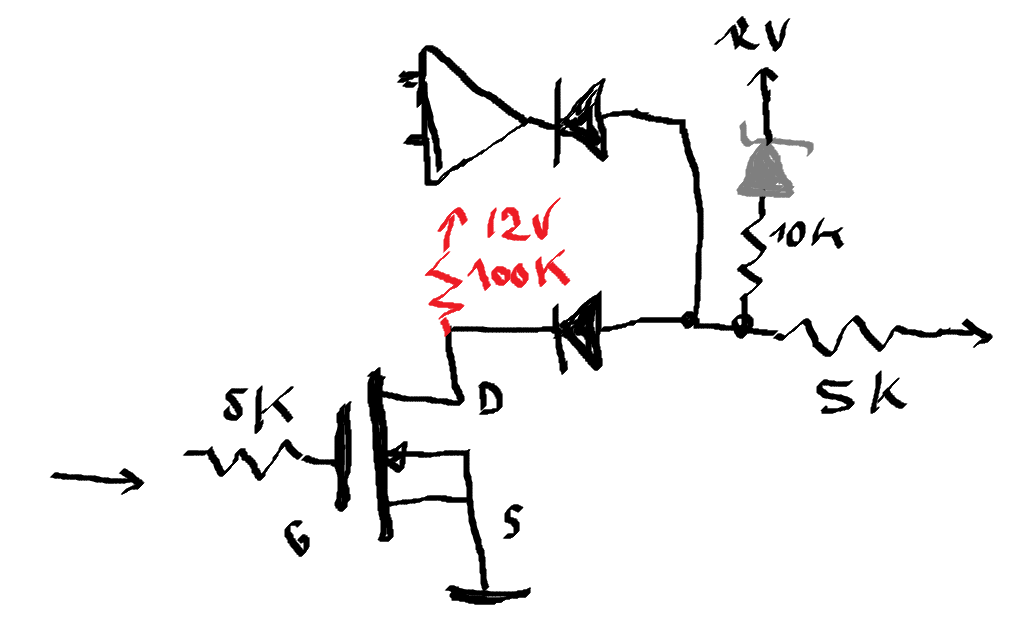

    I could add a small switch-friendly FET.

    0 Jan Cumps over 9 years ago in reply to Jan Cumps
    jc2048, do you think that an open collector PCA9557DPCA9557Dwon't do in this case
    It only has to keep the signal at approx 0V when engaged, should be masked from what happens at left side of diode when high-Z (would it suffer from 7V minus a diode drop in High-Z config ? maybe yes ...)

    0 jc2048 over 9 years ago in reply to Jan Cumps
    If there's ESD protection just above the 5V level, then that will catch the diode and limit the diode OR node to maybe 6.5V or something like that (not high enough for the operation we want, though it would do if you built a version with a logic-level power MOSFET on the output). If there's no ESD protection, then you lift the output until it starts to breakdown - not a disaster because of the 10k limiting the current so much, but it still catches the voltage, only we don't know where (that's hackery, not Real Design(tm)).
    Don't make it too small - I can just about manage Small-Outline-Transistor-number-23 (SOT23) packages.
    Either a MOSFET or a BJT would do. BSS138 has a low enough threshold voltage to work well with a 3.3V gate drive. Perhaps include a pull-up resistor on the gate so that it is held on at reset (disabling the load) until the processsor is ready to start controlling everything.
    Looking at that circuit fragment, you might want to lay out your board so that it can be built without the 6V zener there. (Although you could just link across the pads, it would be neater, and easier to document, with a parallel placement for a zero-ohm link as an alternative build.) The circuit won't work if you leave the zener in there with the MOSFETs Peter wants to use. (That's not quite true, because the gate voltage slowly drifts up to the threshold on the zener leakage, but it is true to say the circuit won't operate the way you'd like it to.)

    0 Jan Cumps over 9 years ago in reply to jc2048
    Jon, how would you provide the VDD in this scenario?
    - Not, and rely on the voltage from the node before the diode,
    - or add some resistor to +12V (that shouldn't influence that node because of the diode)
    Your pen looks much more stylish than my pencil.
    The pull-up to the expander rail will keep the BSS138 on at start-up, when the expander output will be high impedance, and that will result in the load being disabled until your code sets up the expander.
    It would work fine without the pull-up to the 12V rail but, if we do reverse bias the signal diode, that minimises the [drain] capacitance that the diode-OR node will see. Not really an issue because it's only a few hundred pF and everything is so slow anyway - the op-amp can't see it from behind its own signal diode, so that's not going to worry about it [and could drive it, anyway, if it had to]. It just adds fractionally to the time taken for the (3k3) pull-up to turn the power MOSFET on if you don't have it there. For the cost of the placements, you might as well put it on the pcb and decide if you need it later. The 0R is there so that you can leave out the zener, but there are other ways to do that if you want [link or zener with footprint that could also take a resistor].
    I'd reduce the 10k pull-up to 3k3 if I were you because the larger MOSFETs need more drive (the gate capacitance is higher) and the 10k compromises the speed a bit too much (it becomes the limiting factor frequency-wise rather than the op-amps and the servo loop).
    You need to get Peter to say what he's going to do for hardware protection before you finalise the pcb. The processor can do some things - like limiting the average dissipation - but it's not fast enough to deal with transients coming in from the output leads and that kind of thing. After blowing up his previous load in such spectacular fashion, I'm sure he's thought a bit about the things that could be done.
    got it!
    the expander will supply 5V - we're feeding it from the linear regulator on the power board.
    Peter's damage was due to long time overloading and waffling to the camera instead of checking the setup image  (isn't it, Robert Peter Oakes ?). That's something we should be able to handle by software or a fuse.
