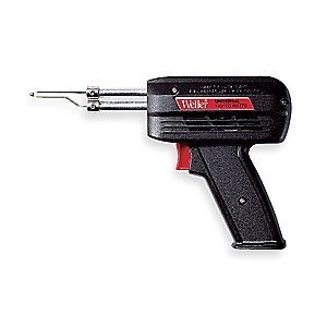

  • rsc
    0 rsc over 9 years ago
    I like to have a large soldering gun at the bench for the times I need to solder some 10AWG to a ground lug and I don't have a propane tank handy.
    You can make your own tips from 12AWG solid copper in various shapes and sizes also.  They don't last as long as the Weller tips, but they will do in a pinch.
    and a heat gun for shrinking heat-shrink tubing.
    Scott
