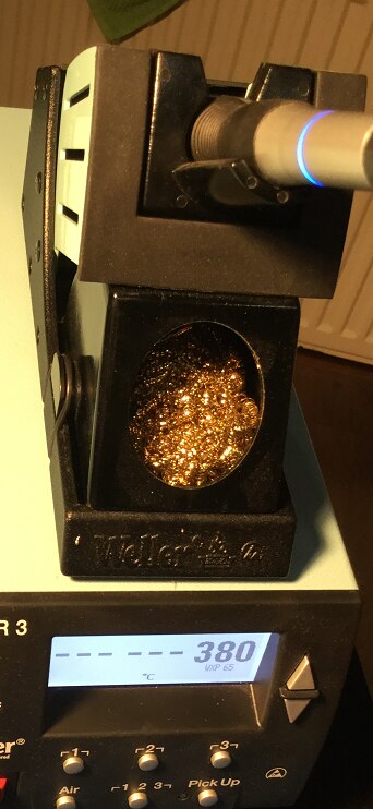

    0 Jan Cumps over 9 years ago in reply to dougw
    Douglas, for many irons the sponge will do fine. I worked with it from 1982 until a few years ago.
    I use brass now because that's what the base of my current station (and the previous one) is made for.
    Also, look at the crazy temperature I'm using image. I'm a lead free kind of person.
