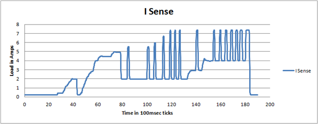

    0 genebren over 5 years ago in reply to baldengineer
    Thank James,
    I will be sure to let you know how it works out.
    I have been using an older, analog Electronic load (Kikusui PLZ 72W) for a few years now.  It does allow me to test my load protection circuits, but I really wanted the ability to program load sequences, so I could test these features as a part of my QC tests.  Today I was testing a new design, applying various loads and seeing if the load and time delays were functioning properly (manually switching between two load levels). (values captured through USB link to the device under test).
    It looks like the BK 8500 could do all of this, plus capture the voltage and current levels.  (I hope)
